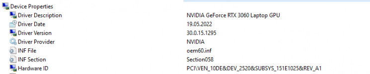

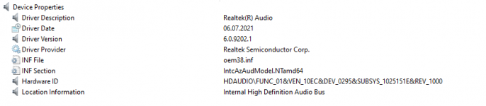

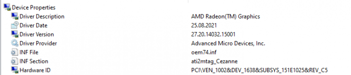

Can you run DPCIManager in macOS? You can dump the DSDT with that.
Also if you have Windows, see if you can make a note of the hardware ids in Device Manager,
mainly for the GPUs and/or audio codec. Also name the codec if you can.
A check for the WiFi and BT (if they are Intel or Broadcom) is also needed.
Mac os not installed

Okay that looks good. Let's see what we can do now.
We'll need to look at that DSDT as well.
Reactions: lev12354
