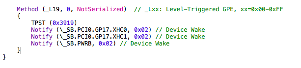

I do have a DSDT.aml I created from DCPIManager, will that work? (Attached it to this post)
  • DSDT.aml.zip
Yes it works fine.
Okay so I've opened it up. It looks like you have two USB controllers names, and one is not PTXH.
It's XHC0 & XHC1.
In addition it has a path of _SB.PCI0.GP17 and not _SB.PCI0.GP13 as in one of the SSDTs we
were using with the B550. That explains why it's not working as it should.
Alright so I've gone and made the changes to the files.
Give these SSDTs a try.
  • Legion 5 XHC.zip
