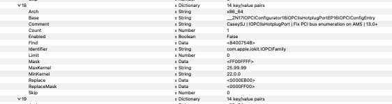

- SMBIOS iMac20,2. AMD_Vanilla patches (core count = 0x10), ProvideCurrentCpuInfo = true.
- Booter: DevirtualiseMmio = true. MmioWhitelist is built from this board's DEBUG log:
- Devirtualised: only 0x1080000000
- Also: DisableVariableWrite = true, SetupVirtualMap / RebuildAppleMemoryMap / SyncRuntimePermissions = true
- ACPI:
- SSDT-EC-USBX-DESKTOP. The LPC device is SBRG.

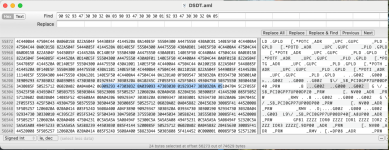

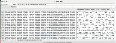

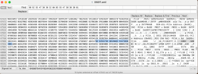

- Custom SSDT-CPUR with 32 Processor() objects. This board defines the CPUs as \_SB.PLTF.C0xx (ACPI0007).
- etorix AM5 patches #1 and #2, with a mask so they work on both BIOS versions. Both apply ("replaced 1 of 1").
- Result: ACPI now loads clean ("15 ACPI AML tables successfully acquired and loaded"). Before, 4 tables failed.
- UEFI: ReleaseUsbOwnership = true.

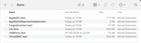

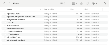

- Kexts: -x (safe mode), and only Lilu + VirtualSMC + AppleMCEReporterDisabler
- CPU: cpus=1, SMT off, SSDT-CPUR, FSB 21 MHz vs 99.8 MHz
