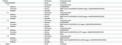

Obtaining the MmioWhitelist patches for this system was simple enough using OpenCore Debug version and following the Dortania guide for using the DevirtualiseMmio Quirk.
Screenshot 2026-10-02 at 20.59.35.png MmioWhitelist patches for my ASUS PRIME X670E-Pro WiFi board using BIOS 3265 x64
