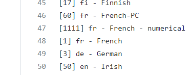

Sorry I use a USB audio speaker attached to my Dell display, so I never looked in to whether the built-in Realtek audio works. I know it doesn't work with AppleALC.kext.
When I was using this system on Yosemite and El Capitan, VoodooHDA.kext was all that was needed to get audio working, but it was never great.
Unless you are based in the UK and use a British PC keyboard you need to remove or change a couple of entries in your config.plist.
Boot Arg - bcmfx-country=GB should be changed to bcmfx-country=Fr (assuming you are based in France). If you don't need this boot arg delete it from your config.
prev-lang-kbd > en-GB:250 should be changed to one of the French keyboard options below. Or just remove the British PC keyboard entry.

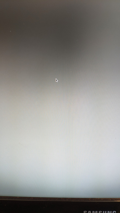

Hello Edhawk,
Thank you for your message and help. I used your EFI and change the SMBIOS to MacPro7.1.
It worked on the first boot but I did not install. I did all my backups and disk clones first.
Then I wanted to proceed with the installation and I'm stuck on a gray screen with only the mouse visible after the Apple logo.
It is not a problem of key, like fakesmc or nvram?
I don't dare to change the config.plist settings.
I attach the EFI with Macpro 7.1.
Do you have a solution?
I really appreciate your help, so thank you in advance.

What is strange is that at the first attempt to boot with your efi, I arrived at the Monterey installation window. After I made my backups of Big Sur.
I decide to do the installation, I have not changed anything in the EFI and this gray screen appears after the apple logo, only the mouse apparent.
I created the bootable usb key several times with the same results
How long did you wait with the Grey screen and mouse showing before you rebooted the system?
You may need to wait for a significant time (15-20 minutes as a minimum), as the macOS installation sometimes pauses (appears to stall but hasn't) for some long periods, especially on older AMD systems.
You need to be really patient with the macOS installation.
What would also help is if you remove temporarily any other SSD/NVMe/HDD drives, leaving just the proposed macOS drive and the macOS USB installer plugged in. As other drives can cause unnecessary issues/delays in the macOS boot process.

I managed to install Monterey by starting the installation from app store update and continued until the migration of my data.
The problem is during the loading progress with the Apple logo, when switching to the video driver, the screen becomes black with a bar that appears with the mouse cursor.
I am sure that this is a setting with my Radeon rx 570 graphics card.
Could you please look in the latest EFI attached.
Thanks in advance.

Monterey is installed but I can't reach the login window.
I placed the EFI folder in sz partition Monterey. The problem remains the same as with the EFI of the bootable usb key
I managed to boot to Monterey. Everything worked but I have a problem with the login screen .It crashes everytime I turn on my PC and I can't login
Hello, I have the same problem as you, have you found a solution? My graphics card Radeon Rx 570 and you, witch do you have?
What version of Monterey do you have installed?
For my part Monterey 12.6.1
Thank you in advance for your reply.
I don't see anything wrong or requiring attention in your EFI.
Which graphics card are you using?
Hello, Radeon rx 570. Are you sure you EFI opencore 0.83 work with Monterey 12.6.1. I try to find the solution of the black screen just before the login window, I find nothing.
Try adding the Boot Argument agdpmod=ignore and see if that helps.
