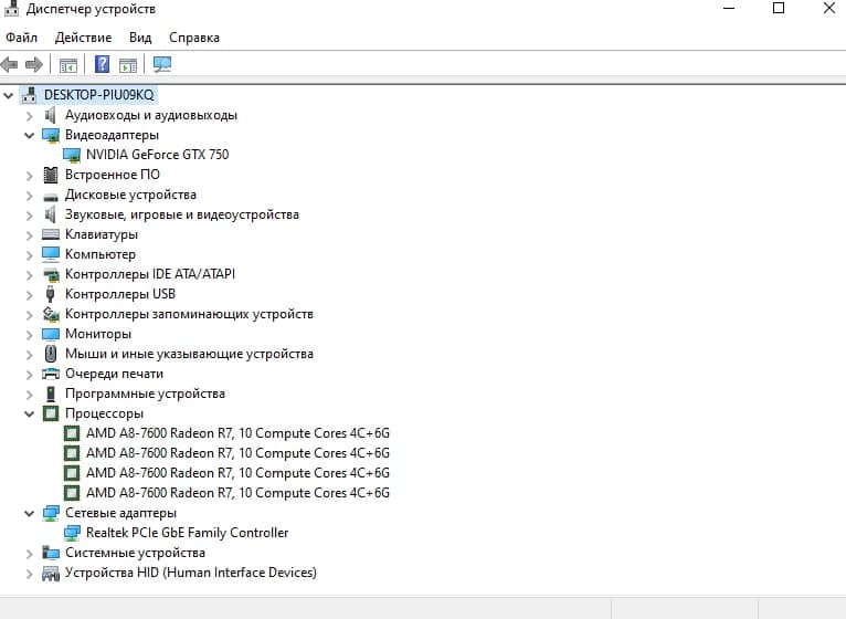

I have amended the EFI I posted for the FX 8350 system above to better suit your 4-core Kaveri CPU. I have provided a copy of the revised EFI Folder in your other post.

1. Motherboard - HP 2B52
2. GPU - NVIDIA GEFORCE GTXX 750 2GB
3. CPU - AMD A8-7600
4. ETHERNET - Realtek PCle Gbe Family Controlle

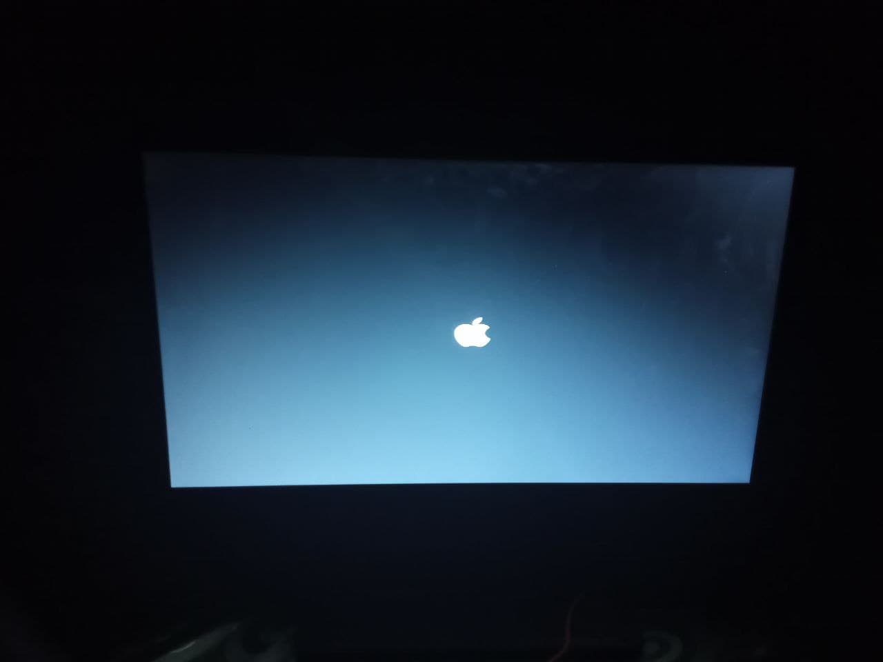

What can I do when installing macos mojave freezing mouse ?
We need to enable the Kernel >Quirk>XhciPortLimit entry in the configuration.plist. So your USB ports work.
