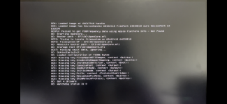

I also see the codes before the boot selection. It looks like some files are missing.

2,516
Not sure which EFI you are using, but all the missing Key's and WatchDog errors shown in the screen images above, are present in the revised EFI I provided in post #22. Is that the EFI you are currently using?
I have looked through your system DSDT.aml and used it to generate a few custom SSDT's for the revised EFI attached below.
I have also changed your SMBIOS data to one that contains all 4 x SMBIOS entries, plus a few other edits that should help your system boot macOS.
Use the attached EFI as it stands, don't change anything. Let me know if this works or not.

2,516
The screen image above shows your system is having issues with the SSDTs in your OC setup, where devices listed in the SSDTs are not being discovered.
Ryu
Feb 24, 2024
32
How can I repair the ssdt? It looks like the usb devices issues form the device address.
