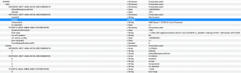

2,372
Installing/adding RestricEvents.kext is sometimes not enough. In that there are options available to make sure you have the correct CPU, Memory & PCI elements set in your config.plist. These can either be by using boot arguments or Nvram entries.
For example the NVRAM section of my Ryzen 7 5700G/Asus TUF Gaming B550M/RX 5700 XT system looks like this.

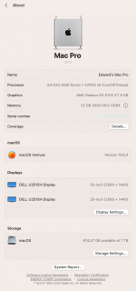

You will note that both the ADD and DELETE 4D1FDA02-38C7-4A6A-9CC6-4BCCA8B30102 sections are populated with additional entries. These are options available when using RestrictEvents.kext that will help the system use the correct CPU name, MEM and PCI attributes if using the MacPro7,1 SMBIOS and allow OTA updates. I have also added a custom CPU name, using the revcpuname option. This CPU name carries through to the About this Mac and System Settings tabs, as shown below.
Screenshot 2024-01-25 at 17.23.01.png About This Mac
Screenshot 2024-01-25 at 17.23.31.png System Settings > General > About tab.
Details of these and other RestrictEvents options/Boot Arguments are shown on the Github page linked below.
Thank you so much. I amended my config plist according to your instructions and now the cpu name is shown correctly in the "about Mac".
I trust that I will still be getting the OTA updates, correct? (I deleted the "revpatch=sbvmm" argument from the boot arguments and just added the "sbvmm,auto" in the revpatch line.

2,372
That looks Ok as far as the RestrictEvent entries in the NVRAM section.
You don't need -lilubetall boot argument, as you are not using a beta release of the OS. Doesn't help you have mis-spelt the boot argument (-lilubetaall) either, as the entry you are using is missing the second letter 'a'.
