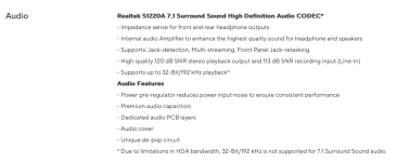

The Asus Prime X670E does not have USB audio... it probably works perfectly??
I helped an user with ALC897 codec but they still had the issue without Speedkeeper... I'll do more research about it...
Umm just tested my built-in dac and my audio is bad with lots of static clicks without Speedkeeper.
But if I may ask is there a difference between an external dac on a USB port and a built-in dac over the USB protocol?
You mean the internal USB audio? The difference is that your external DAC uses its own timer instead of the CPU's which is not synced to the OS'.
