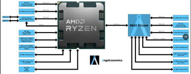

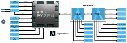

Has anyone tested how the B650E behaves?
If all goes well, I'm going to have an Asus B650E-E Gaming for the week...
I was hoping it would work without the patch because it's not like the X670E which has two chipsets controlling multiple PCIe:

the B650 has only one and MacOS may like it better 😁
