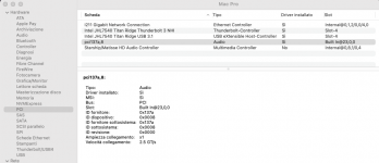

So now my PCI section looks like this (Thunderbolt shows there, with driver installed, together with the Audio interface connected via Thunderbolt).
And looking at the Audio Interface menu, it also reports "Connected via Thunderbolt" and Audio functions correctly, so Thunderbolt is definitely working.
Strangely, in system report, "Thunderbolt" still shows "No Driver Loaded"... but I guess I can live with that!
