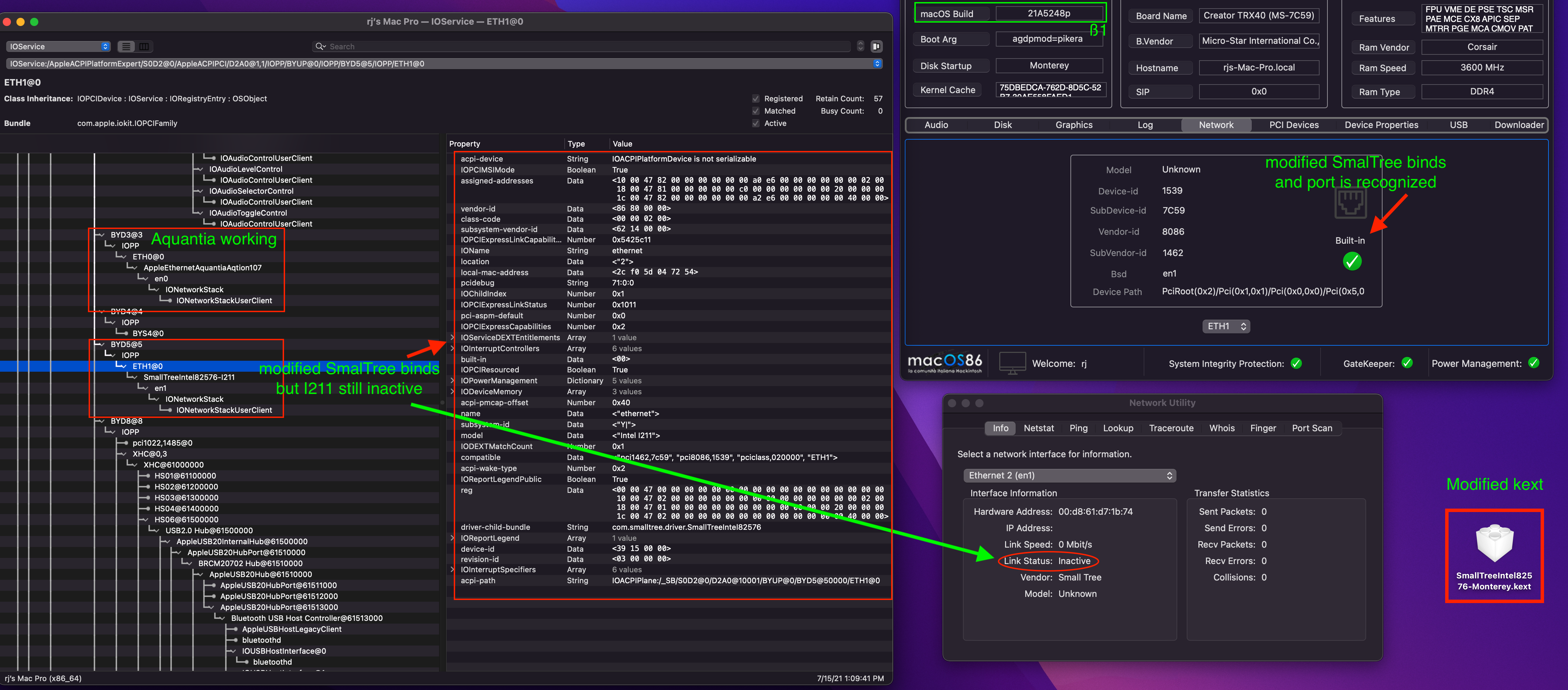

I've been working on a SmallTree modification; it seems close. Shown in the attached image is how the modified SmallTree kext binds to the proper site in the left side (IORE) and how the port is now recognized in HackCheck app (upper right), but the port is inactive in Network Utility app (lower right).
Meanwhile, the Aquantia port works with a new patch for Monterey. Also, I've gotten BT and Wifi to work on ß1, and so AirDrop works as well with ß1 as I reported on a TRX40 thread on the macOS86 forum.
But I've only been able to test the modified SmallTree on my TRX40 mobo under ß1 (as I'm too lowly and undeserving of patches for anything > ß1 :cry:).
Once I get patches for ß3, and if it works, I'll share the modified kext. The kext is currently being tested together with a custom SSDT file. (There's another avenue of approach to the problem, but I don't want to bother with it until I see if ß1 is the problem.)
