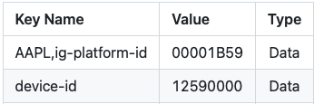

Use these settings for the HD 530 IGPU, they might fix the spoofing issue for your Skylake IGPU.
Screenshot 2025-08-13 at 19.24.40.png Skylake to Kaby Lake IGPU spoof.

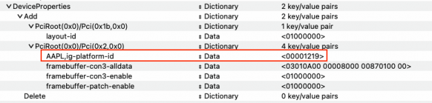

You are using the Kaby Lake Framebuffer.
Screenshot 2025-08-18 at 21.21.20.png Kaby Lake Framebuffer

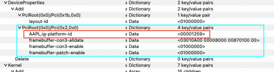

Screenshot 2025-08-18 at 21.24.44.png Skylake Frambuffer
Revised config.plist contains the Skylake Framebuffer.
I assume you know what you are doing with the other IGPU DeviceProperties.

Well as I see it you are only adding the data for one of the graphics connectors on you system using Con3. That means that the others i.e. Con0, Con1 and Con2 are not specified using the 'All-Data' method.
You should look on the Hackintool > Patch > Connectors tab to see which connector is related to Con3. Hopefully it is the DisplayPort connector you use.
The connector in use will normally be highlighted in Pink on the Connectors tab.
