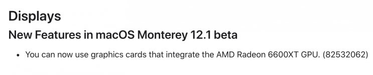

beta 12.1 Out! (AMD 6600 XT support added)
