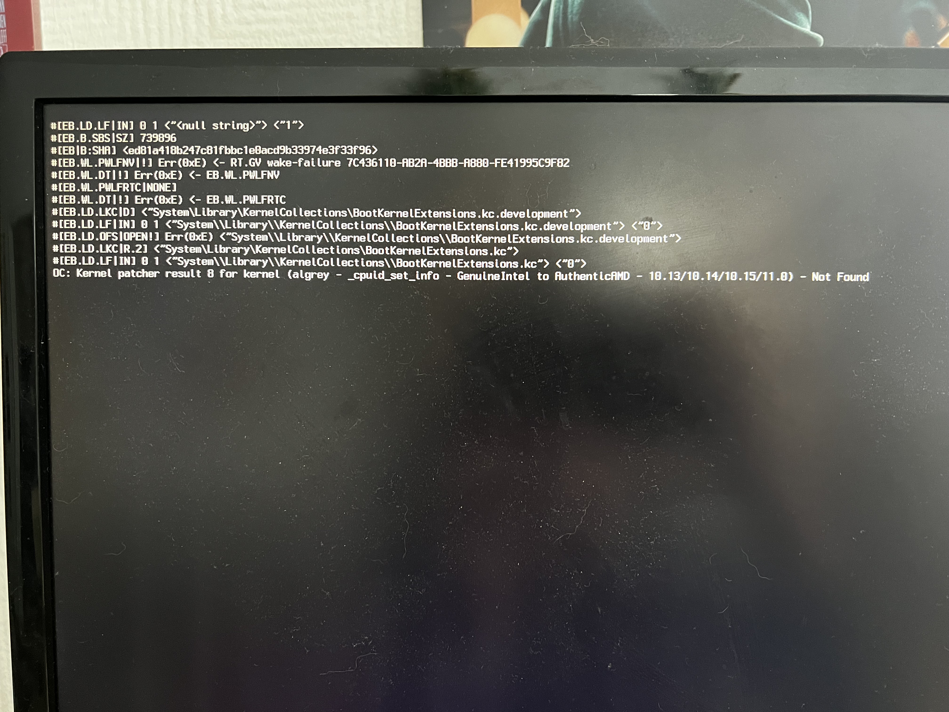

Can you check my config and tell me what did you change and I didn't. I'm using OC 0.8.2 and all of my kexts are up to date.View attachment 6048

Is the kernel patch used before?View attachment 6048
I tried with Mac 7,1 and 1,1.
Thank you, now I am stuck in the logo and language selection and cannot continue the installationYes, the kernel patch is slightly modified, check it out
How long does it take to boot MacOS? I have the same SSD but the boot takes a long time because of the controller.View attachment 6048
