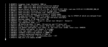

Dear Tucano,
Could you please help me look into my problem? Thanks

Someone already discovered how to fix this? It has been stuck for a pretty long time. I don't know if I have to wait or do anything else… Done every step of item 8.
