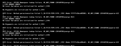

Hello,
Unfortunately I cannot start the setup. The VM was created under VMware 17.5. However, a VM with hardware compatibility 17.0 was also created as a test. Neither led to success. The following loop appears in the bootlog:
Reactions: tonight_at_ten
Hello,
These messages are normal. They should end when the installer reached the next stage.
You must also read my post carefully: :cool:

Hello,
Did you set this up in VMWare?
Normally this is not available. You need to do this:
1) Download Unlocker to patch VMWare
2) After installing VMWare close it.
3) Extract all the unlocker files into a folder, open the command prompt (terminal) in administrator mode and run "win-install.cmd".
This patch releases the Apple Mac OS X version configuration option in VMWare under Virtual Machine Settings, Options, Apple Mac OS X:
use "macOS 14" when configuring your virtual machine
Reactions: boltes
Hello, I gave the boot process more time and now the installation worked perfectly! Many Thanks (y)
