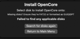

I am not getting any boot gui when starting macos even after following all the directions. attached is a screenshot.
1) Config vmware to 1 processor 4 cores (primary cause for the stuck right at the beginning as shown in your screenshot)
2) Disable hiper-v on windows
3) Patch vmware with unlock tool.
This patch releases the Apple Mac OS X version configuration option in VMWare under Virtual Machine Settings, Options, Apple Mac OS X:
use "macOS 14" when configuring your virtual machine.
4) Set Hard Disk (Sata): macOS_Opencore_1.0_4_cores.vmdk (SATA 0:0) should always be the first boot drive.
In newer versions of WMWare choose "Keep existing format" if you are asked when adding the image of this drive.
All these procedures are described in more detail in the tutorial.
