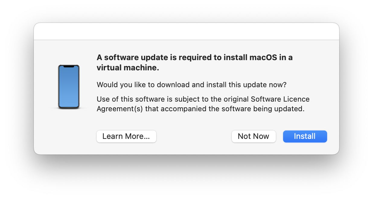

were you able to login to icloud on beta2? when I try I get 'Verification Failed', same for when I upgraded beta2 to beta3
It seems that Apple really is limiting access in Virtual Machines and it would be a case of asking for this feature to be included even when the host is Windows:
I also couldn't log in to iCloud, Apple Store and I get the same error in all beta versions of Sequoia.
I don't know exactly what Apple has changed in this version of macOS.
It seems that this occurs in macOS on virtualized systems only such as VMWare.
It could also be a problem with the network driver that VMware uses, vmxnet3.
Maybe it only happens with the beta version. Just a guess!
If you or anyone else finds out how to solve it, please let us know.
check this:
thanks again for the macos14 vm, it works great. the only thing i wanted out of sequoia was the remote iphone controls but from reading through the links it seems like fully function macos15 vm's arent likely anytime soon
