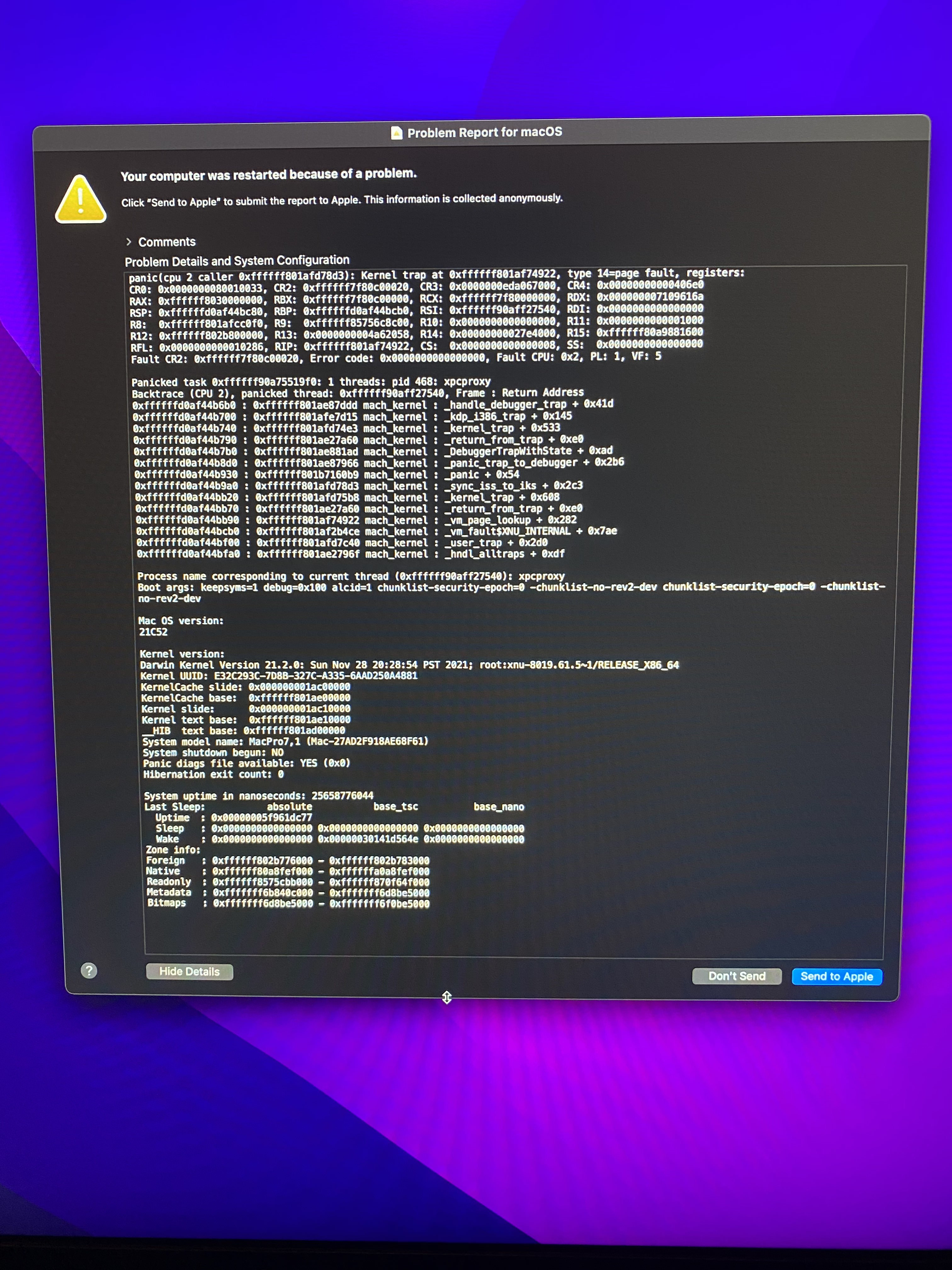

Hi there,
I have created a fresh install of Monterey and updated to 12.1 everything was working like a dream.
I got everything up and running but and booted this morning but it kept on restarting, I could just about manage to take a screenshot of the panic below. It restarted about 7 or 8 times until I gave up. Sometimes it would restart before logging in, but aftre about 5 seconds of successfully logging in it would restart.
I'm really not sure if this has something to do with my EFI or hardware. It's strange that I spent 4 hours on it last night and it suddenly started to restart randomly in the morning.
I have tried:
  • Reseating the memory
  • Updating EFI
  • Checked for any driver mismatch.
  • All Kexts seem to be loading properly.
I would be really appreciative if you could have a look at my EFI it for me.
Its here https://github.com/ainsleyclark/ryzentosh
Thanks in advance.

When you boot to OpenCore press the spacebar and clear the NVRAM. Then try booting again.

2,171
Are you using XMP for the RAM? Try disabling it to check. I've seen the xpcproxy panic relating to RAM before.

2,171
It might be a software issue in that case. Any programs that run on startup etc? Try booting the recovery and run First Aid on the drive.
