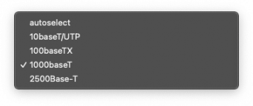

Have you tried manually specifying the speed in the settings?
Thanks Shanee, yes after trying all the settings, I still get the lower speed. Also, when I select 2.5, things disconnect completely (even after trying standard vs jumbo MTU and the duplex options).
