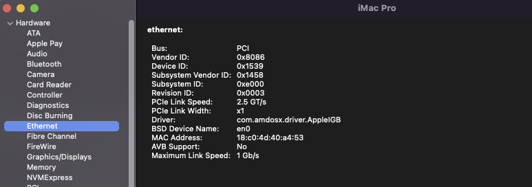

Unfortunately both kexts posted here fail to work after a short time. Running a ping test it works for about a minute then times out. I’ll get more details like device Id etc tomorrow.

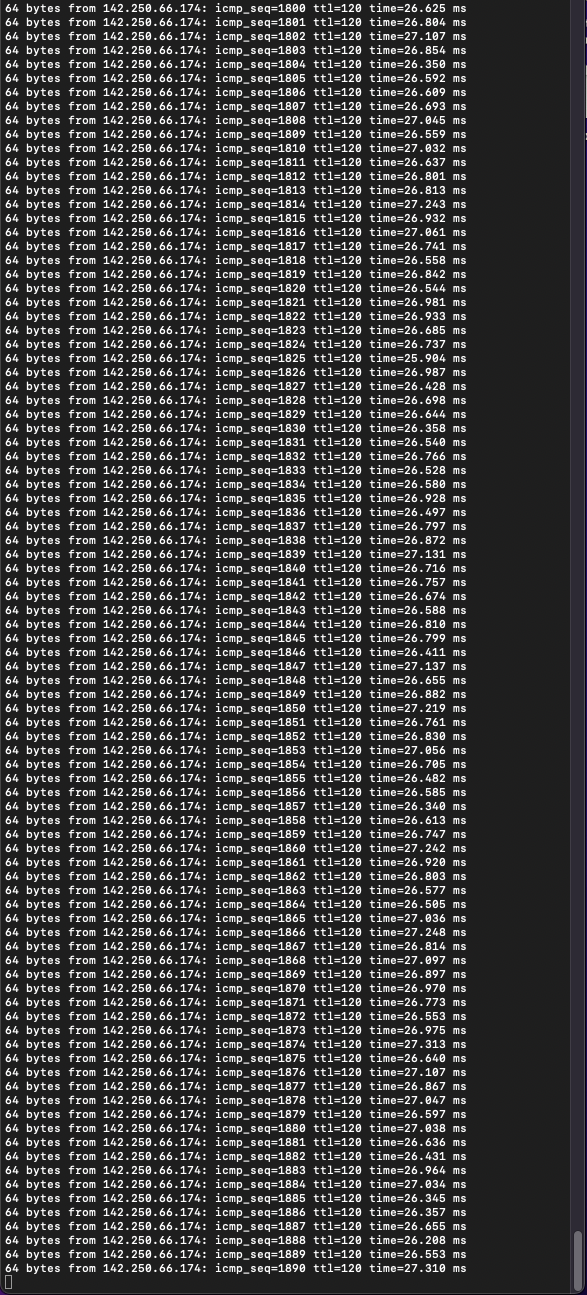

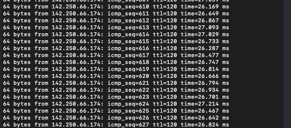

I'm not sure about any changes between the kexts, just reporting my finding and mine is that the AppleIGB_i210i211.kext works flawlessly for me as shown by my ping count.
The constant ping may be keeping it alive. Don't run ping and leave it idle for a bit and check on it later and see if it's still active.

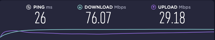

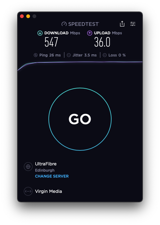

Seems consistent, Im downloading a load of files and running speed tests while doing so and so far so good.
Il leave it idol once what's downloading is finished for a while then do the rest of my downloads and see if its still holding its connection.
