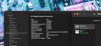

Working fine on a ASUS X570-E using Monterey
  • DeviceID: 0x1539
  • Subsystem ID: 0x85f0
  • Subsystem Vendor ID: 0x1043

Can you try this version please.
  • AppleIGB.kext.zip
baronerosso
Sep 29, 2020
103
It works 1 minute and ... stop, but no kernel panic.
I found this kext on https://www.macos86.it , if anyone would test it. Works on BigSure as the "original" SmallTree and on some motherboard AMD with Monterey, but doesn't work on Trx40
  • SmallTree-Intel-211-AT-PCIe-GBE.kext.zip
2,167
baronerosso
Sep 29, 2020
103
2,167
It just drops the connection? Check in the console app for any errors as to why please. Also is it set up manually or Automatic in System Preferences?
baronerosso
Sep 29, 2020
103
Just drop connection.
No errors in console regarding the kext.
Changing set up in Network-Advanced-Hardware from Automatic to Manual and again from Manual to Automatic solve, the connection restart, but … only for a minute!
2,167
@reinierlazo You're still using SmallTree as per your screenshots.
@baronerosso Unforntauly I'm not sure why. I'm by means no developer, all I've done is update the AppleIGB kext source to the Intel IGB Linux driver v5.7.2. Beyond that I'm a bit lost.
@iGPU You were working on SmallTree, any thoughts on this? I've attached the original kext source and IGB driver if you're interested.
  • igb-5.7.2.tar.gz
  • AppleIGB.zip
