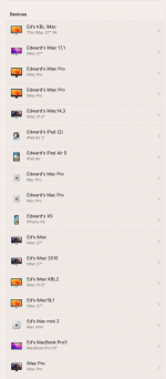

The new SMBIOS will just be added to your iCloud account as a new system. I have 21 systems in my iCloud account.
Screenshot 2023-06-11 at 22.50.03.png Screenshot 2023-06-11 at 22.51.03.png iCloud systems associated with my main account.
View attachment 10999 View attachment 11000 iCloud systems associated with my main account.
