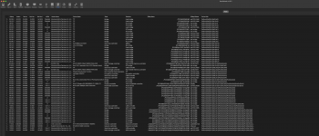

If you open Hackintool and navigate to the PCIe tab, do the following:
  1. Move your mouse cursor to the left-hand edge of the Hackintool app, it should change to a double-ended arrow cursor.
  2. While this double-ended Arrow cursor is showing, drag the left-hand edge of the app towards the edge of your display, this should make the app wider.
  3. Then do the same on the right-hand side, so all the text is shown in the main PCIe tab window.
  4. Then take a screenshot of the expanded PCIe tab.
I'm going to take my dog for a walk, be back shortly.
Reactions: errevi
I've done what you say with the app window and enlarged the columns width at the maximum i could but still is not enough
