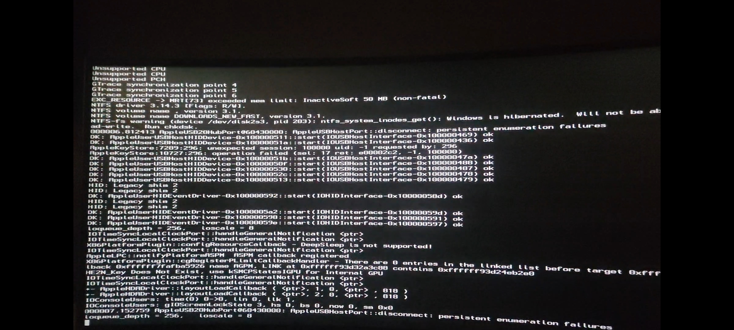

Hello anyone get big slur booted on 3950x with a 570 motherboard thank u guys much appreciated I used a efi folder I found but I get issues here is a pic of issue

so got this booted with a different efi folder but no network

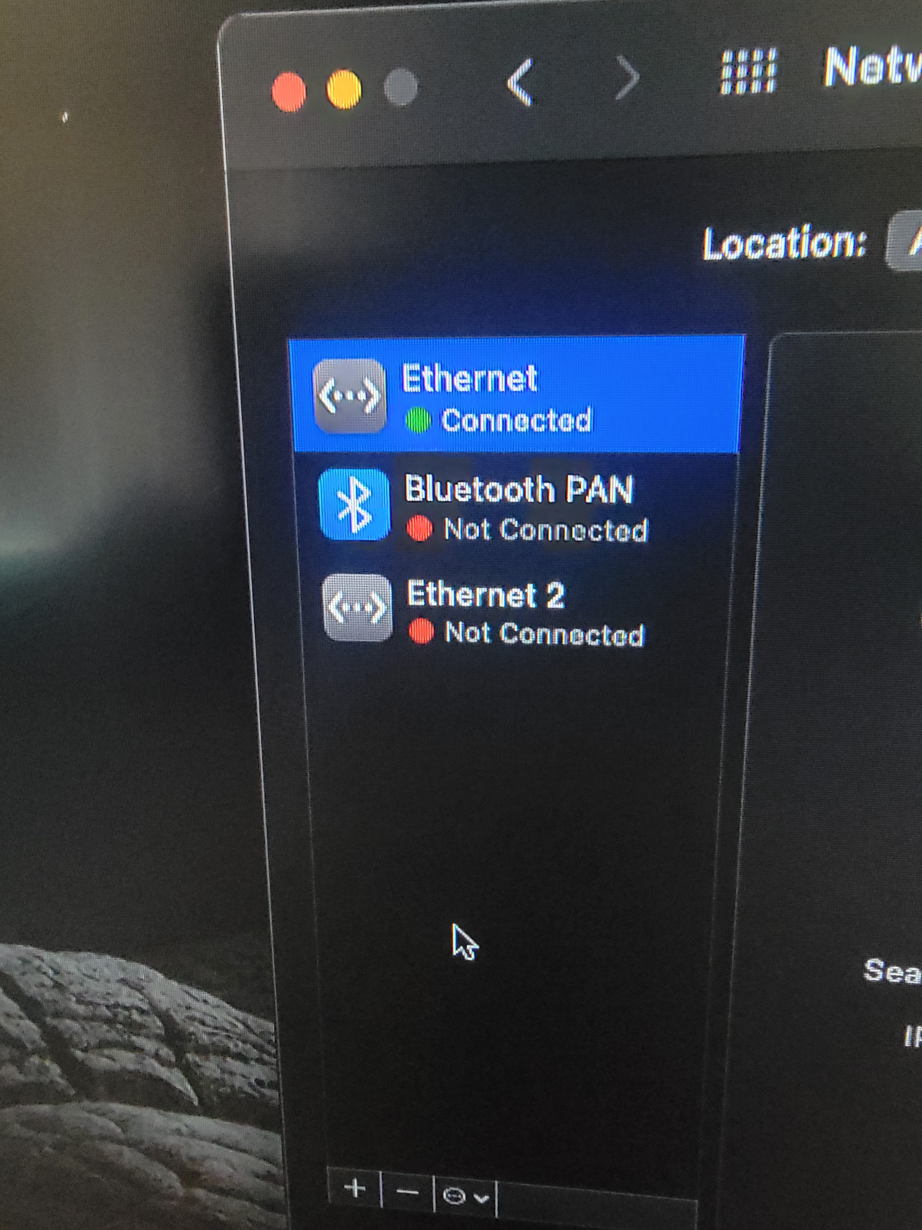

ok so i couldn't wait so i went and tried it all I can say is THANK U so still wifi is broken but the wired is working perfect thank u so much

For your WiFi and Bluetooth add these kexts.

Ok so please looks like need help on couple more issues no sound at all but Bluetooth works as in it connects to airpods but it still shows as red but u can hear sound from airpods and still no wifi after those kext

just wifi and can't sign into the cloud i get an icloud_unsupported_device

Hi yes I did add that kext to the kext folder for wifi still nothing as for the en0 where can I check that because it only shows the ip address and so on

Use hackintool, it will show you if it’s set to internal but It should be anyway tbh.
Have you entered smbios details for 7,1??
if not then that’s what you need to do
