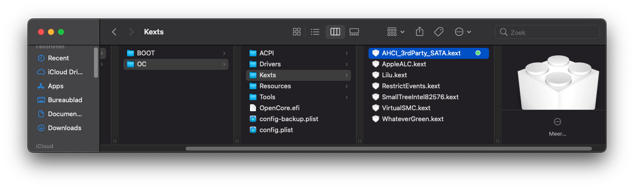

Thanks Shaneee! Everything works, even Metal. Final question: Is it possible to get my dvd-drive working in Bug Sur?

Try with that kext then. Does it show in System Information at all?
Edwin
Jul 25, 2021
108
Kext is inserted but no results.

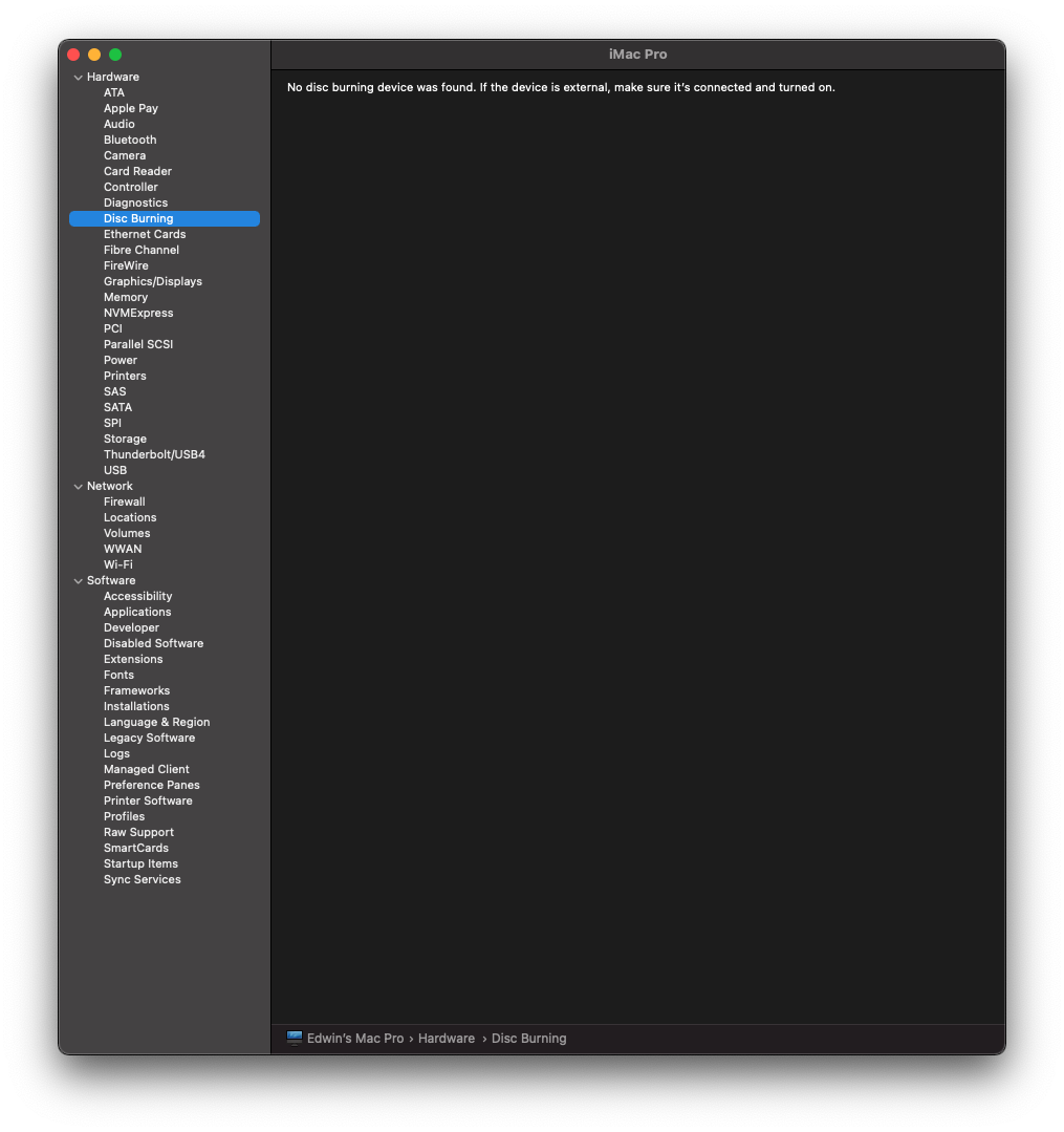

Is it picked up in System Information or in Hackintool?
Edwin

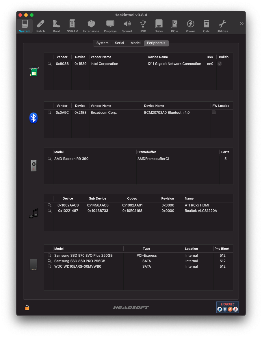

@Edwin if the DVD player was active in macOS it would appear as shown in the following screenshots:
Screenshot 2022-01-20 at 20.19.33.png Hackintool Peripherals
Screenshot 2022-01-20 at 20.20.00.png System Information > Disk Burning
Screenshot 2022-01-20 at 20.20.16.png System Information > SATA

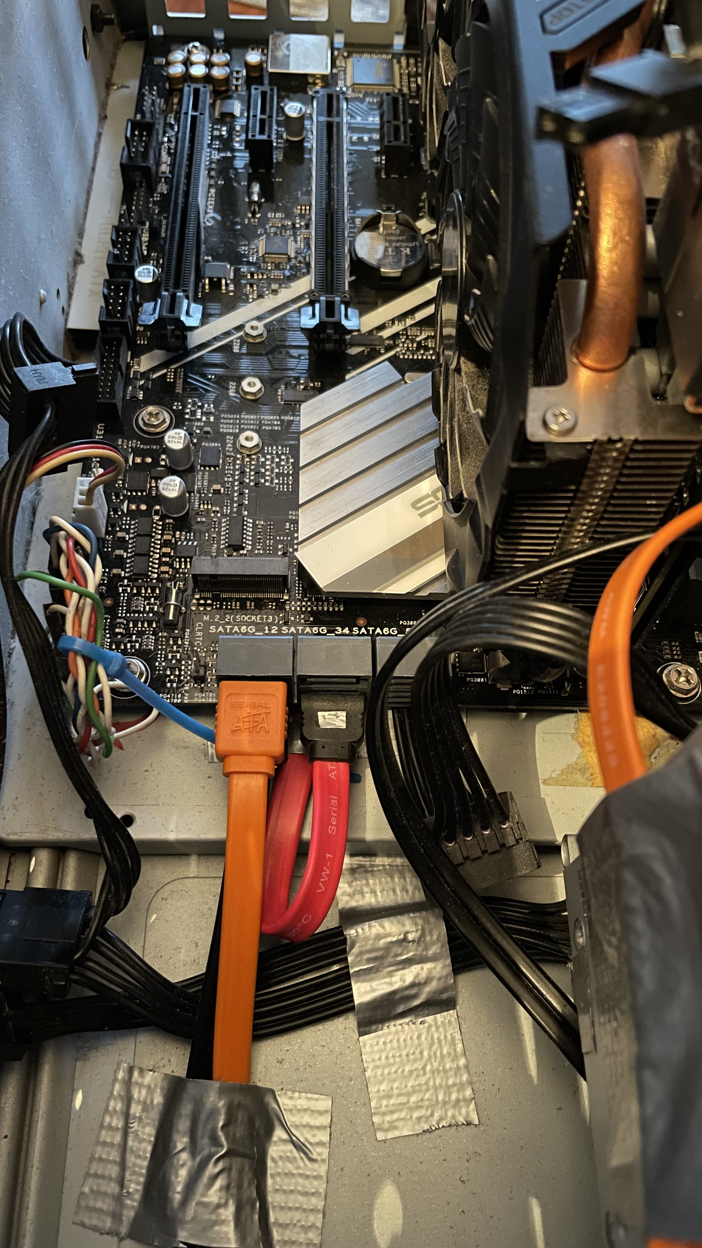

Which SATA port do you have the DVD connected to in your system?
The DVD device will be working at 1.5GB not the full 6GB that a SATA port can provide, this is normal. The drive should work with any functioning SATA, SATA2 or SATA3 cable, because of the native speed of the drive.
There are 6 x SATA3 connections on your motherboard, as shown in the screenshot from your motherboard's user manual:
Screenshot 2022-01-20 at 20.26.57.png SATA ports on Asus Prim X470 Pro motherboard
As far as I can tell these ports do not share PCIe lanes with the 2 x M.2 connectors. So they should all be available even when the 2 x M.2 connectors are populated.
View attachment 4841 Hackintool Peripherals
View attachment 4842 System Information > Disk Burning
View attachment 4843 System Information > SATA

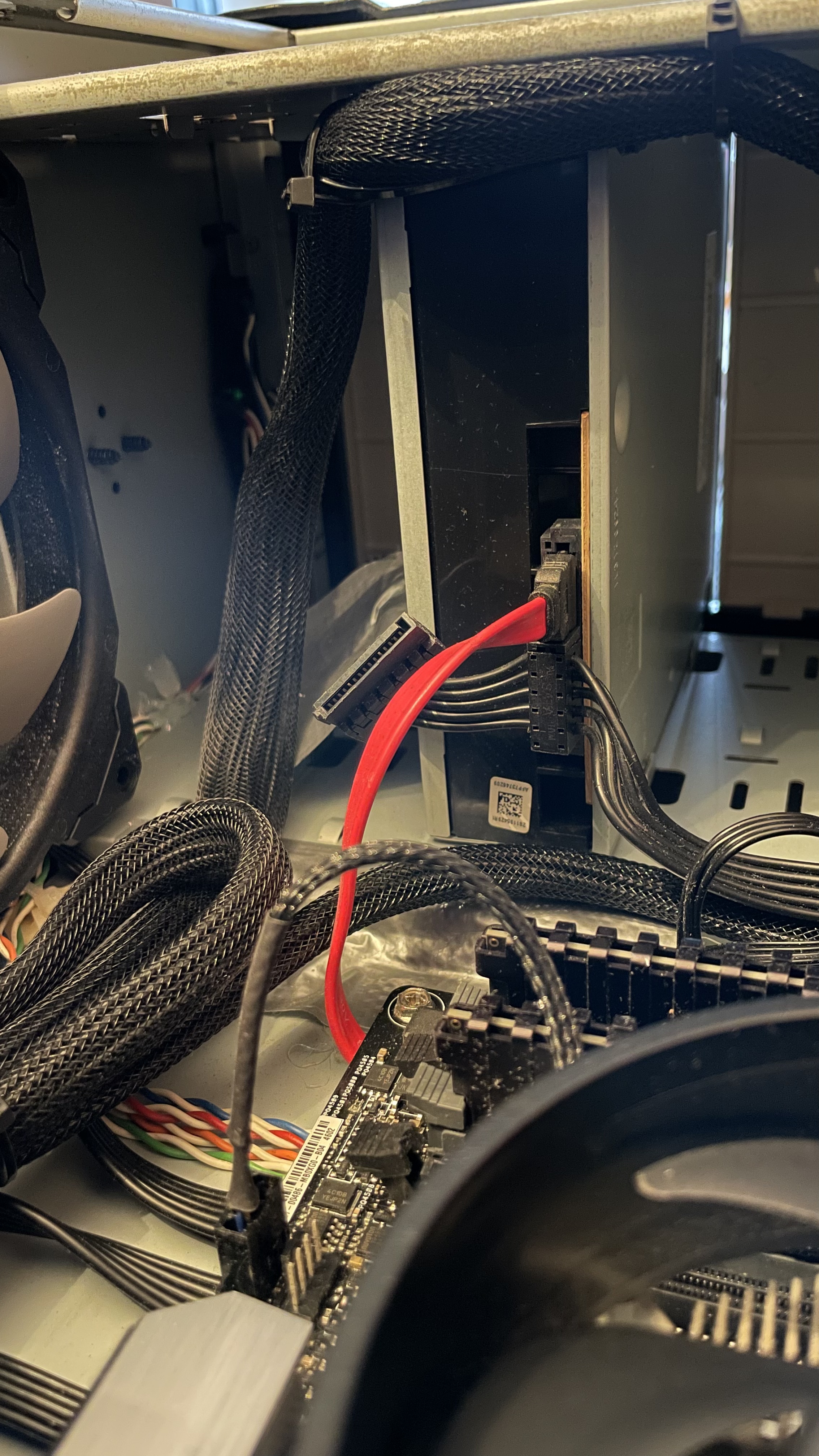

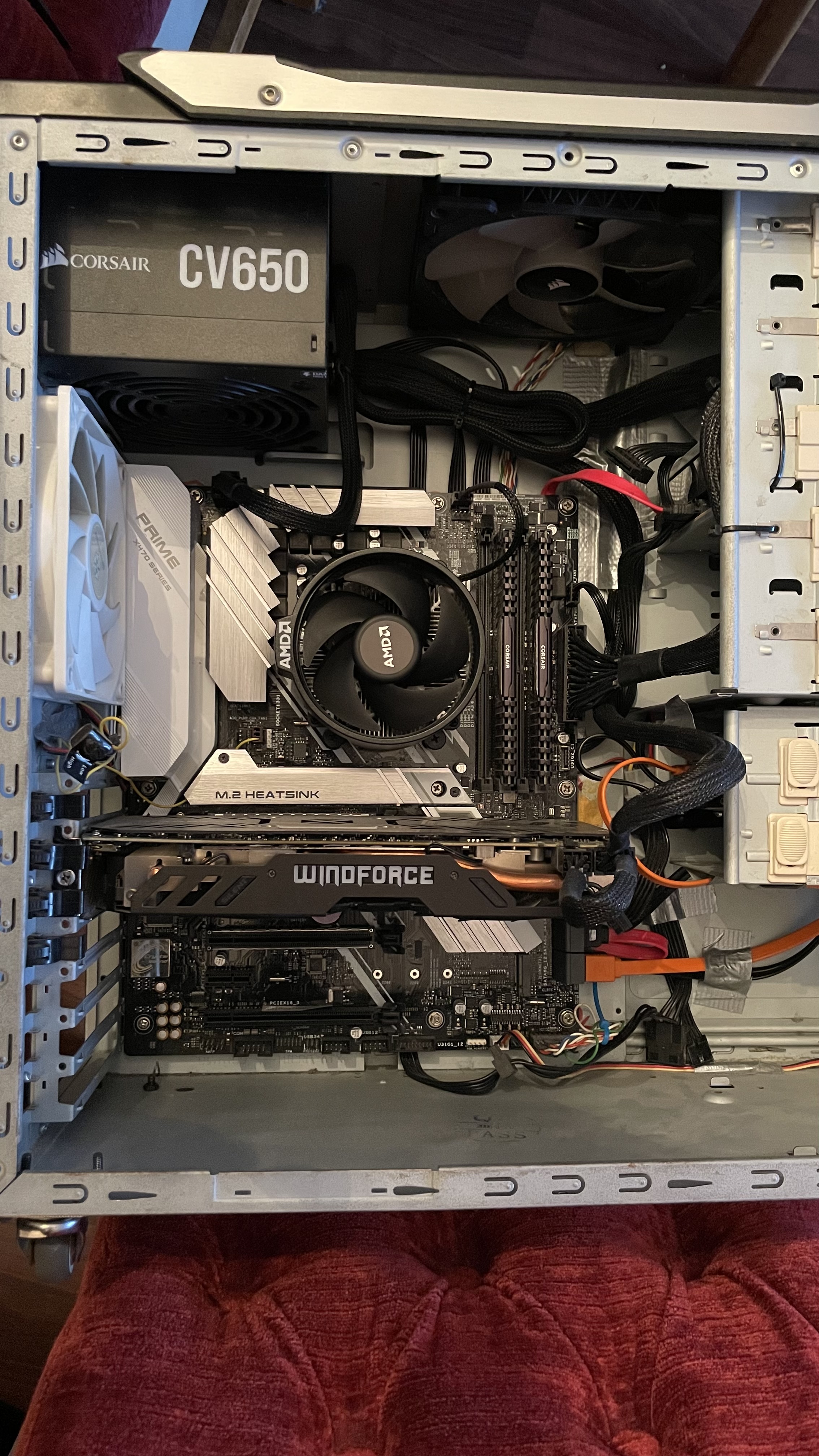

Poop! I checked everything, tried all sata ports but no dvd device is shown in Big Sur. In Windows the dvd drive is visible. Is the kext ok, I wonder?

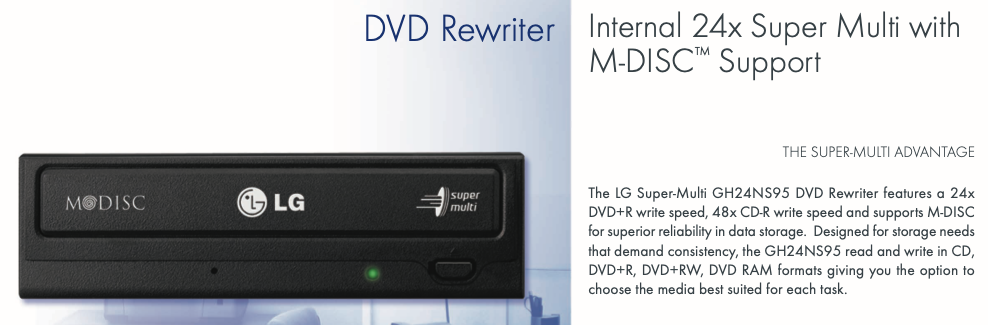

Hi Edhawk, everything works in Windblows eh Windows. But not in Big Sur :-(
This is my DVD Writer:
2,350

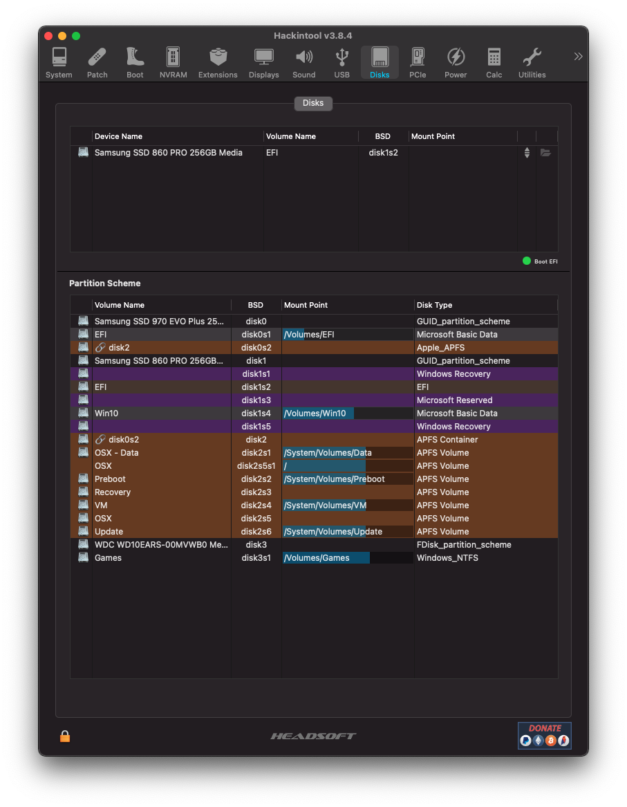

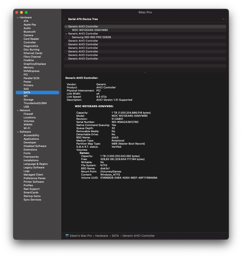

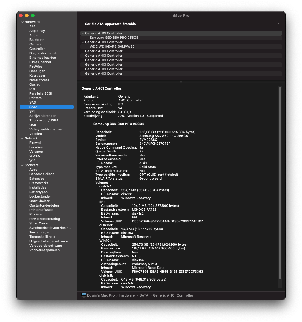

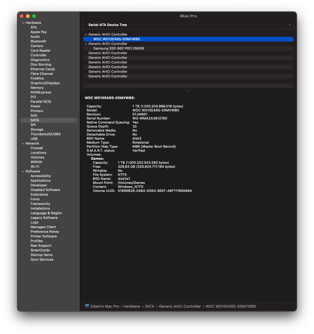

Can you post a screenshot showing the settings for your WD 1TB drive, from System Information > SATA, as shown below in the example from my WD Green 2TB drive.
Screenshot 2022-01-24 at 18.21.24.png System Information > SATA - AHCI SATA drive
The Samsung 860 Pro is a PCI card, so the screenshot above in post #50 doesn't show the correct information. We need to examine the SATA connections, not the M.2/PCI connections.
If your Bios is set correctly, i.e. with the SATA ports set to work in AHCI mode (not RAID), and the SATA power & DATA cables are connected correctly then your LG DVD Writer should work.
Which SATA port are you connecting the DVD Writer through?

2,350
OK, that clarifies a few things.
  • First the WD drive is PCI AHCI drive, used for Windows storage. It is not a GUID/GPT drive, but rather a Legacy Master Boot Record formatted drive.
  • Second the Samsung 860 Pro SSD contains your Windows OS. This is a GUID/GPT drive, so should show and boot from the OC boot screen.
  • Third you have macOS installed on a Samsung 970 EVO SSD (PCI NVME) drive, formatted as APFS. This drive doesn't connect to the SATA controller.
  • The AHCI_3rdParty_SATA.kext does nothing to clarify the name of your AMD X470 chipset/SATA controller. This is not surprising as the kext is aimed at SATA controllers used in Intel motherboards.
These are the SATA controllers found in the ACHI_3rdParty_SATA.kext/Contents/Info.plist:
Screenshot 2022-01-25 at 21.43.25.png Controller Dictionary elements compacted to show all the SATA controller names in this kext. No AMD SATA controllers present.
You still haven't confirmed which SATA port the LG DVD writer is connected to on the motherboard, or if you found any issues with the data and power cables being used by the DVD device.
