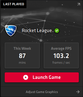

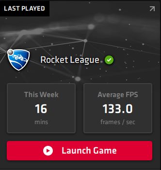

@svan71 Test concluded and the results are the same.
Above 4g Enabled.....
Above 4g Disabled.....
I have a 144hrz monitor so I'm capping the frame rate on rocket league too 144 frames and as you can see with above 4g enabled its around 100 fps but with Above 4g disabled and npci=0x2000 in the boot arguments im hitting my FPS cap. I can show you more examples but i think that sums it up nicely.
@Gigamaxx Sorry to bother you buddy but Have you ever heard of Above 4g Decoding effecting GPU performance in windows like this on any other motherboards by any chance or is this a unique Gigabyte trick?
