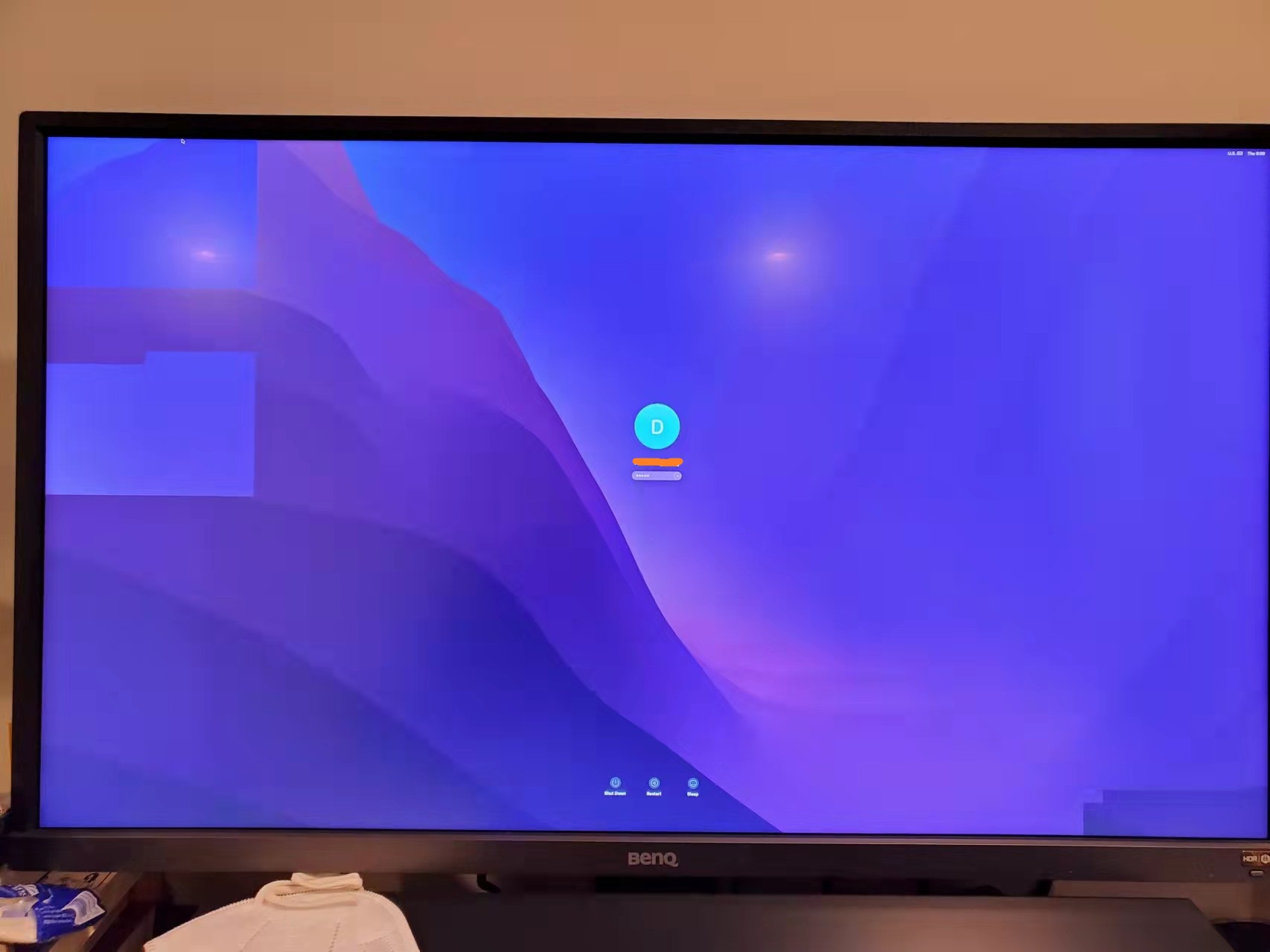

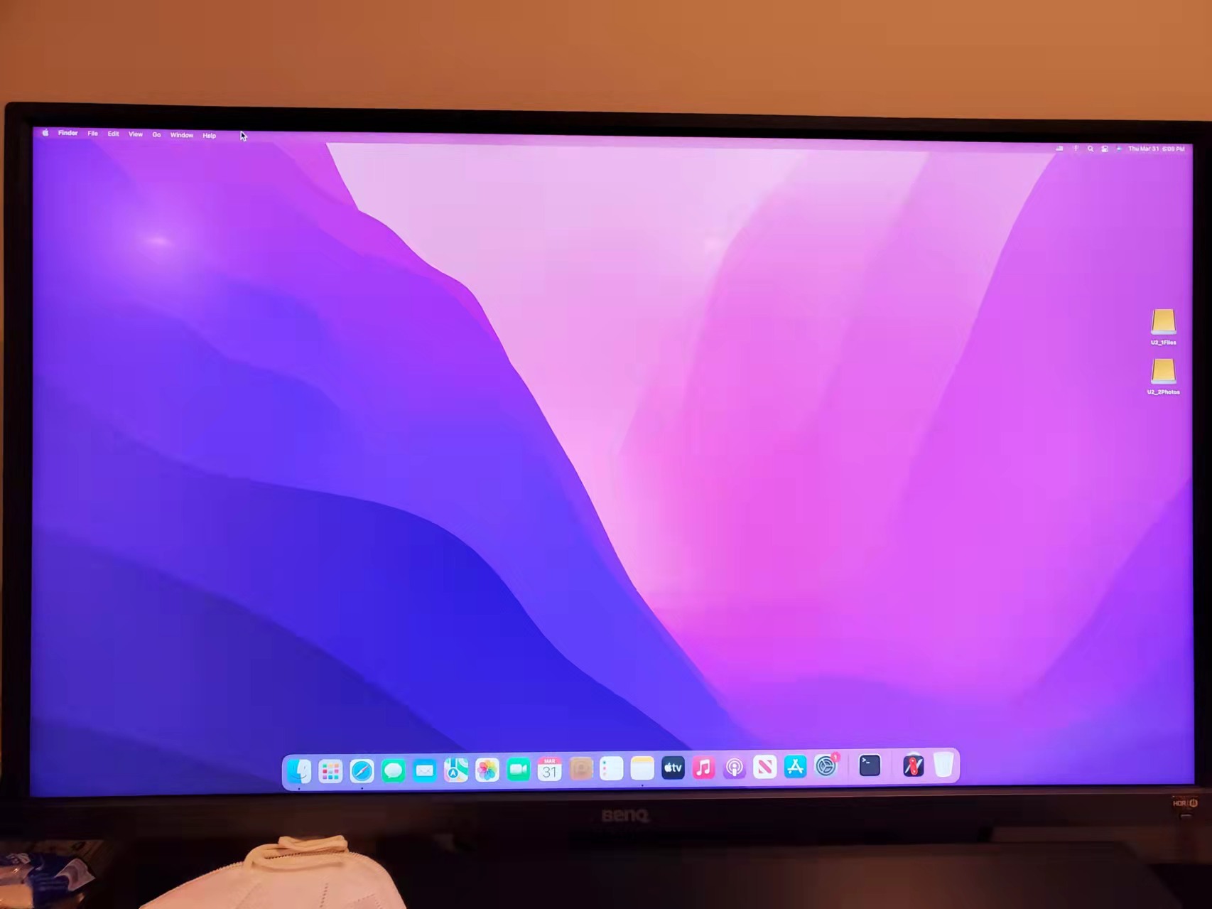

Hi, now My Problem is before entering the MacOS system, The screen has some abnormal color block, After entering the system the color becomes normal. In my case I need to disable NVMeFix.kext and RadeoSensor.kext.
