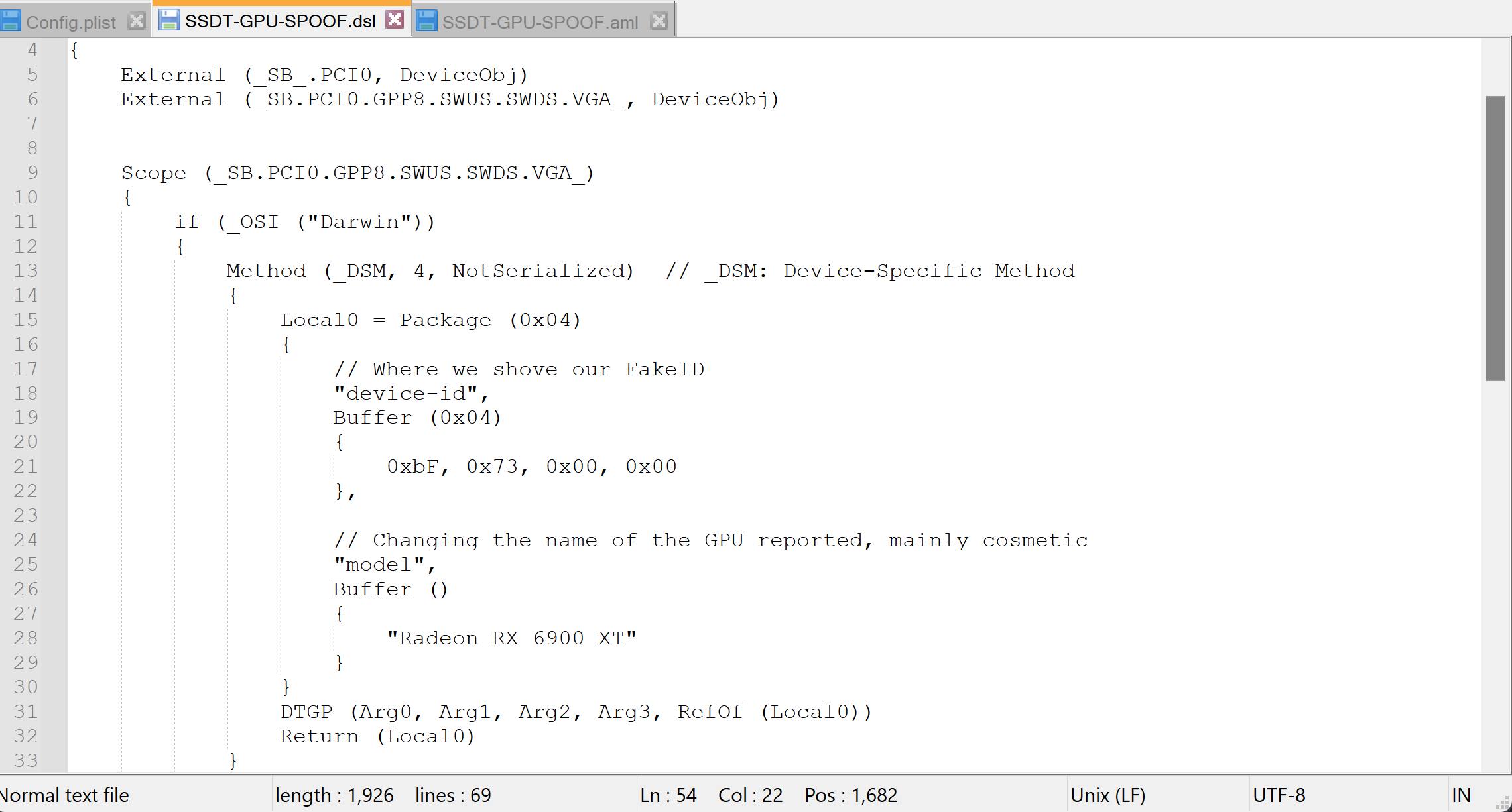

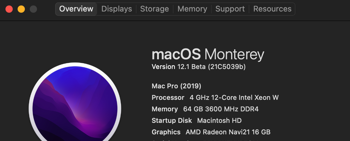

Just tried the SSDT-GPU-SPOOF. It has to setup wrong, because I've never had my system show the correct CPU 5950x or GPU. It only shows Radeon Navi21. I attached my Spoof file.

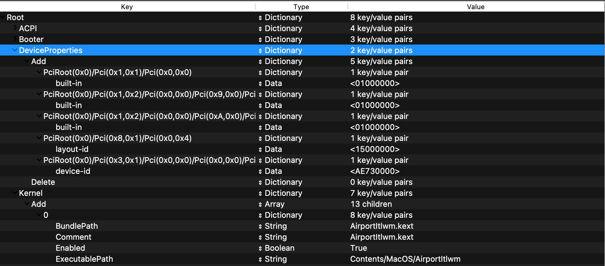

@Jatilq Remove the SSDT approach as it doesn't always work and add this into your config. Just copy and paste into your Device Properties,

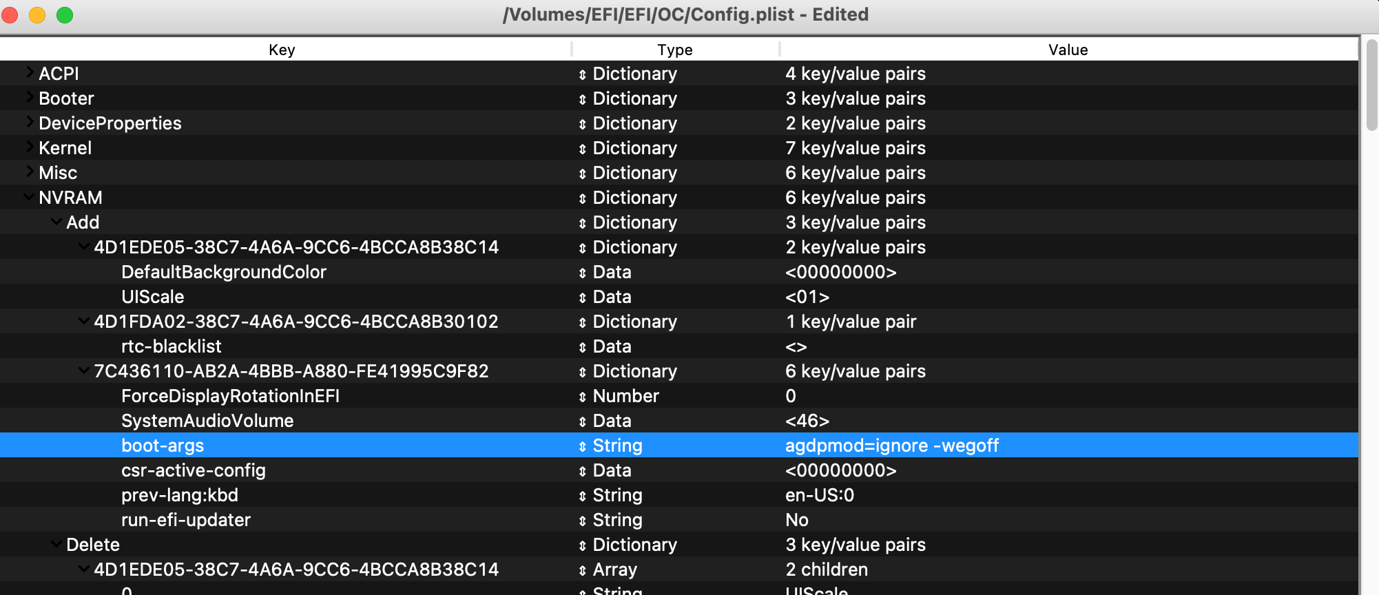

Thank you. I'm hoping the decoder is the reason everything is so painfully slow. I have 64GB of ram, but its like I'm typing this with 4gb. I removed the spoof aml after I corrected it. Pasted the info from your config into my own. No changes with -wegoff on or off. I've reset nvram between changes.

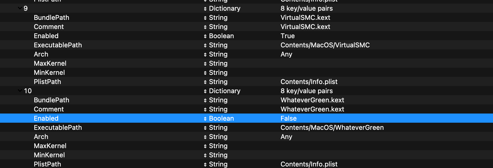

Change the device-id value to AE730000 and try again. You may need to set Whatevergreen to disabled in the Kext -> Add section.
@Jatilq I think the name is cosmetic. It can be changed using the Device Properties too. See if something like Netflix plays fine or run Heaven benchmark.

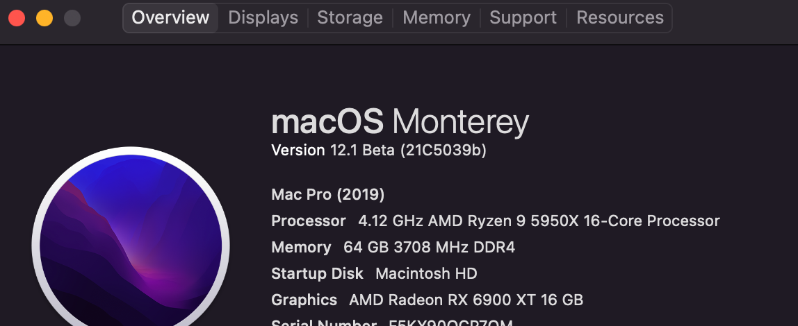

I've tried a few things like other supposed supported 6900xt IDs. Get screen tearing and skipping in Youtube, unless thats to be expected. Plus side I did fix the CPU, had the wrong amount of cores set. Hackintool and VDAdecoderchecker still say failed.
Maybe I'm going about this wrong. My main issue is how slow using a web browser is. I get the spinning wheel most of the time with terrible lag. I figured it was an issue with hardware acceleration, because everything is on a 4.0 NVME.

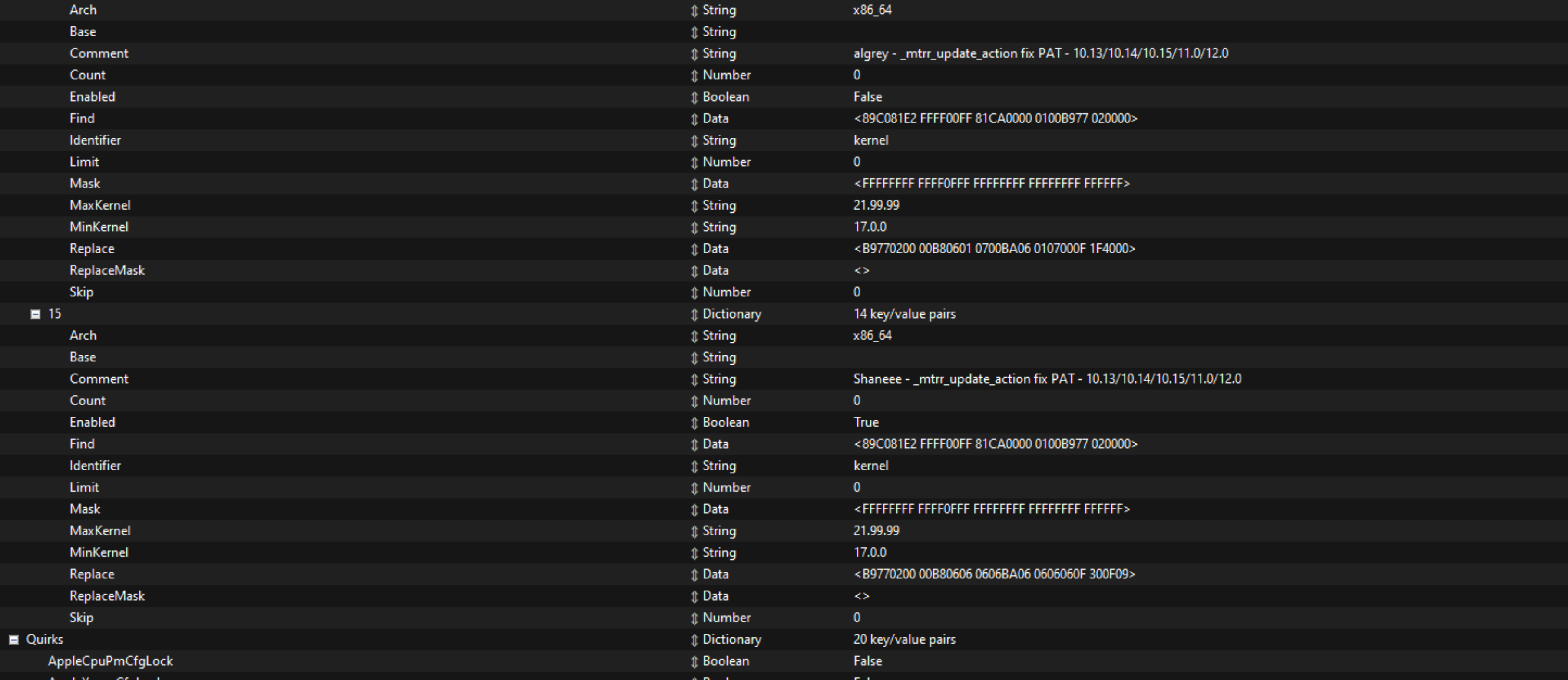

Keep WEG disabled in the config and swap the PAT patch around. Disable Algrey's and enable my one. They are the last two patches.

I don't understand to be honest. I looked at my screenshots to try and figure out what you meant.
I followed this from the guide.

But I don't understand what what to disable. Swap the PAT patch around. Sorry if I sound like a moron. I tried to google this, but the keywords send me all over the place. The Github AMD-OSX page says there are three patches but Im confused. Does that mean patches plist has several patches and I have to only copy 1 or several?

Easier to edit things in windows. I think I figured out what you meant. There are two entries that I should be looking at?
Yes that's correct. My one gives better perfomance on AMD GPUs. Unsure if it'll help you or not. If you wanted to go the flashing route as previously mentioned, to bypass the error you had you'd need to use Linux to flash it. A live USB will do the job.
Thank you for your help. I switched to AMD to be able to do this and thanks to the help from this thread its working. Searching now to see if 120hz is possible.
