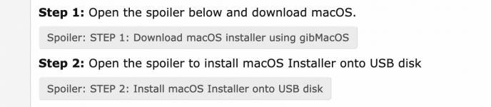

Consider building a new USB install disk by going through STEP 1 and STEP 2 from one of my other build guides:No it shows as Opencore.dmg. I have the recovery image in the folder called com.apple.recovery.boot .

Was this USB install disk created by following STEP 1 and STEP 2, or some other method?So, I had two issues going. I don't know if one was causing an issue. I had two USB drives I was working with active at the same time. I removed one of them. I then reformatted the USB and copied everything back over. I now have some error logs that are somewhat helpful. Before the "OCB: LoadImage failed - Unsupported" error I now have the following. DMG trailer error: 1 - 1246FA81/1246FC81 - 796C6F6B/7B96B1A2 | Failed to initialise DMG context | Failed to initialise DMG from file. Full log attached.
The were both created with the windows method. I used Rufus 4.4. More progress to report. I redownloaded Ventura with macrecovery utility - some success. We are passed the LoadImage error. Current error in log.Was this USB install disk created by following STEP 1 and STEP 2, or some other method?
Because I’m not familiar with other methods, I am at a loss to help troubleshoot those methods.

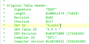

I'm only adding the patched DSDT into OC ACPI/Add. And then apply the RebaseRegions quirk.I may try the new BIOS version and patched DSDT soon.

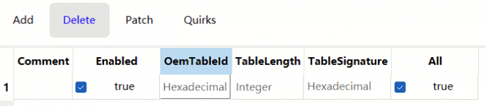

Are you completely dropping the existing DSDT and applying the patched one? We do need to drop the existing one completely.
OC Debug Log:
05:590 00:034 OCA: Detected DSDT at 74464000 of 71028 bytes at index 0
15:980 00:041 OCA: Replaced DSDT of 69496 bytes into ACPI
16:173 00:193 OCA: Allocated new table DSDT at 75D7F000
00:037 OC: Failed to drop ACPI 00000000 0000000000000000 71028 (1) - Not Found
