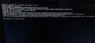

Tested. But stuck in this place.

To boot Monterey with AMD cpu requires AppleMCEReporterDisabler.kext and RestrictEvents.kext. On my B550 build I also enable DisableLinkeditJettison.
But @Edhawk did mention to you your Nvidia GT720 card does not work on Monterey so maybe that’s the problem. You have to change the card to an AMD to run Monterey. Something like a RX580.

Yes you can run the OS with the Nvidia card, but your GPU lacks acceleration and will be jerky with plenty of graphical artefacts.
You can try Chris1111's Geforce Kepler Patcher to see if that helps.
Thank you, but this is based on my entry into the system. Maybe I really need to change a graphics card.
2,416
Changing the Graphics card would be the best solution. Using a compatible AMD GPU would make live a lot simpler for you.
This is the place to look for a compatible AMD GPU.
