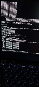

My install hangs at the section below when trying to install Big Sur 11.6.7. It will format the nvme ssd then after first reboot on the ssd it hangs here. I tried removing agdpmod=pikera (which is required for the 6600m to work in Monterey but since it is not supported in Big Sur I left it out since everyone is able to somewhat install big sur without it). Anyone know what could be causing the hang here?

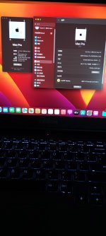

Here is a Geekbench 5 with the Ryzen 5800h on Big Sur
Will do a Cinebench r23 next, since we cant do these test on Monterey due to the core limitation
