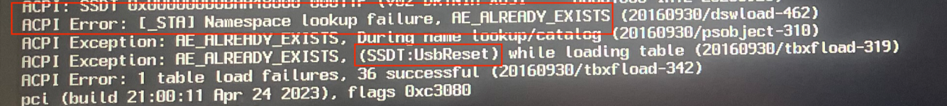

The screen image above shows that one of your SSDT's is causing a kernel panic, i.e. SSDT-USB-Reset.aml.
See screenshot below.
Try removing the SSDT from your setup and see if that helps.
You should also delete the USBInjectAll.kext from your /EFI/OC/Kexts folder and config.plist, as you don't need it with an AMD system. It is set to work with Intel USB controllers, not AMD USB controllers. The Kernel > Quirks > XhciPortLimit entry will still work without this kext.
Try this revised EFI-3 attached below, see if this helps. It incorporates the changes recommended above.
Try the revised EFI on a spare USB pen drive.
Thank you for your fix. The original problem is resolved but it stuck at another place. Is there any fix for that?
