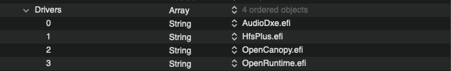

You can't carry across the Config.plist from one revision to the other without using OC Validate first.
as in this instance,
This

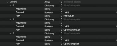

In 0.7.3 is now like this
You were also missing the flavours section in tools.
Here you go, Try now. ;)

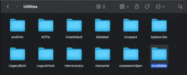

What is OC Validate ?
its a little script that's inside the Utilities folder in OpenCore that will tell you if your Config,plist is in line with the revision you are trying to use it with.
Its a much better idea to use the Config.plist I supply with new EFIs and put your info back into it otherwise you may miss vital changes I might make and it will save you problems as the config will always be inline with the EFI.
