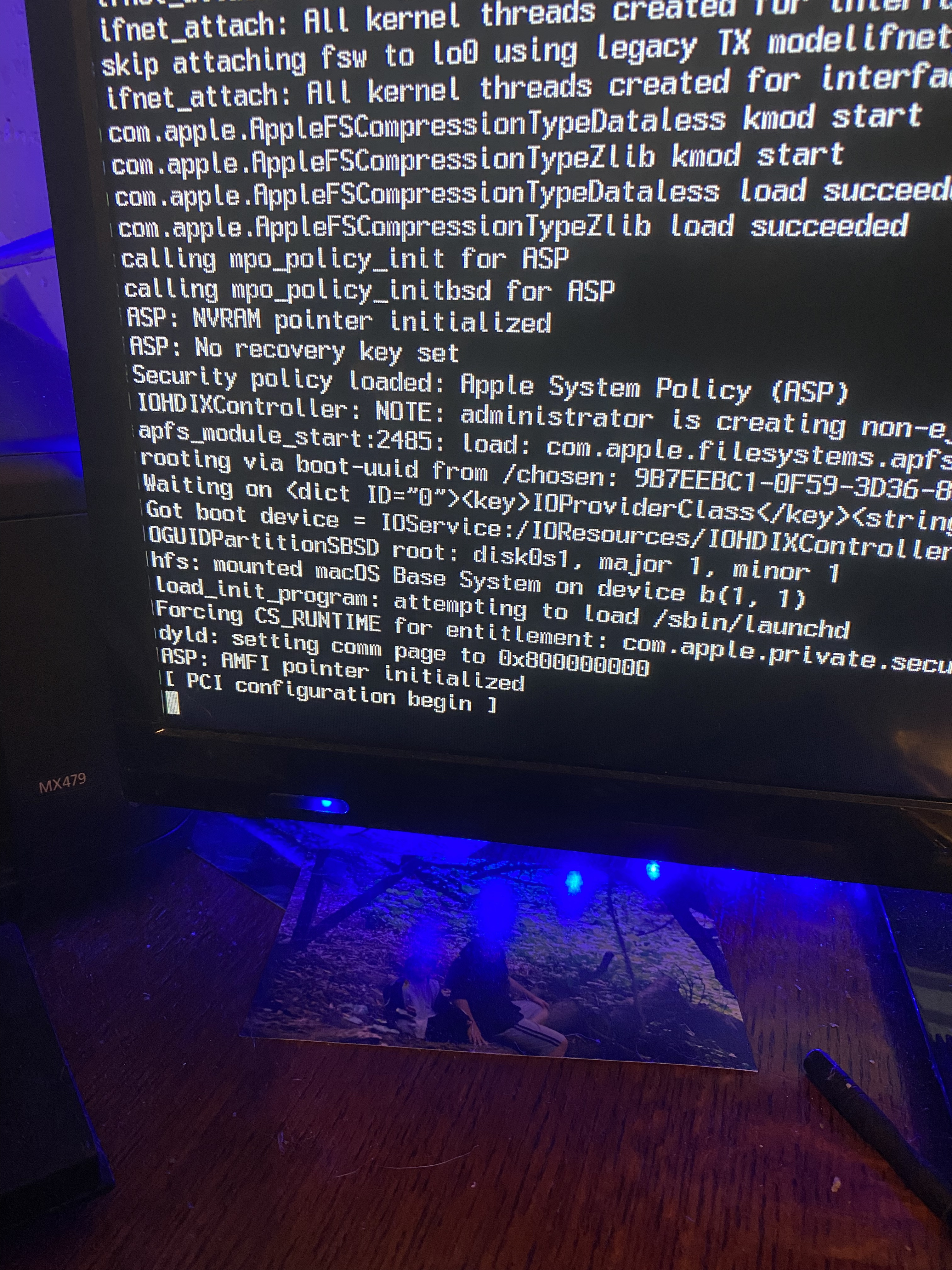

1st timer with Ryzen and opencore
Graystarr
Sep 2, 2021
51
When I boot the USB I get this. Any help would be appreciatedBE9F7F2D-125D-4671-8C6D-C351C15B6A53.jpg

That entire EFI is a mess... What are your specs?

Gigabyte B450M DS3H V2
Processor AMD Ryzen 7 3700X 8-Core Processor, 3593 Mhz, 8 Core(s), 16 Logical Processor(s)

Replace the full EFI folder with this one.

In your BIOS, find and enable Above 4G or add the boot arg npci=0x2000 but not both.
