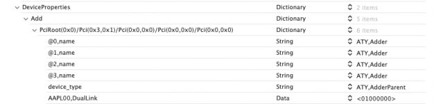

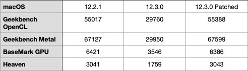

Updated to 12.3.0 and had the same graphic issues so I added this to my EFI config.plist:
This is the results:
And no more artifacts using the Dynamic desktop pictures!
Super happy now.

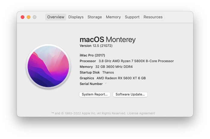

Finally got around to updating to macOS 12.5

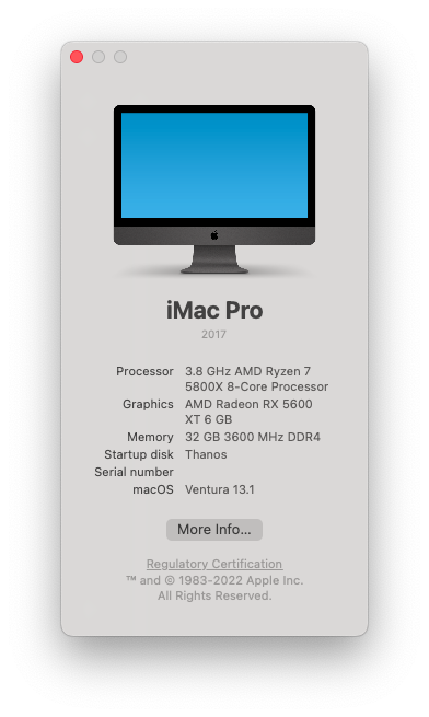

Updated kexts
Updated Kernel patches
Updated OC to 0.87
Updated macOS to 13.1 Ventura
Including latest EFI, works on Monterey and Ventura.

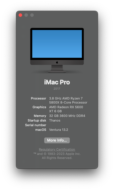

Updated kexts
Updated OC to 0.8.8
Updated macOS to 13.2
No changes to config.plist
