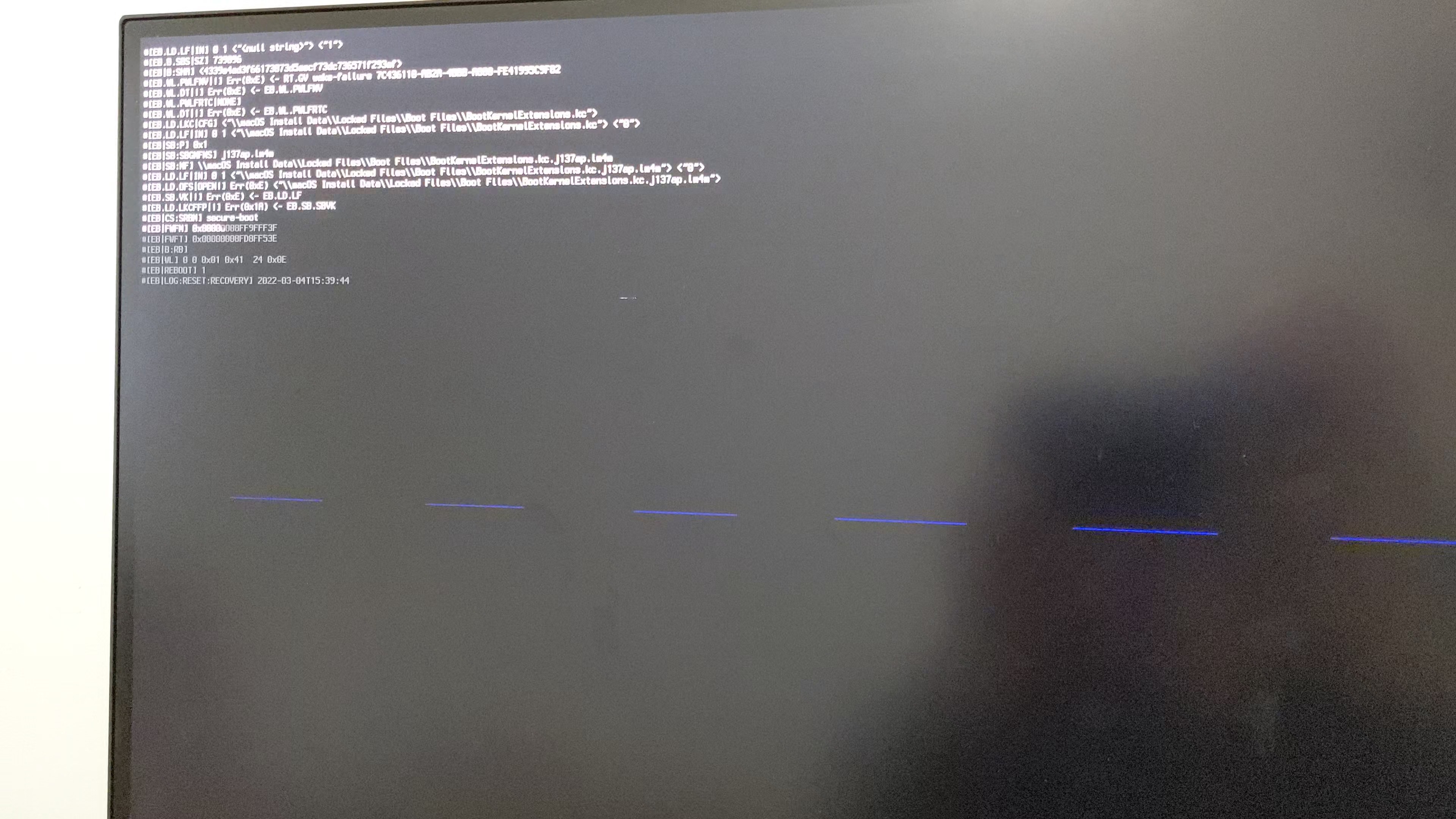

drive and start the Big Sur install process, all appears to be going well until it gets to12 minutes at which point the system restarts, opencore loads and I have the option to boot from the SSD
But.. as soon as I select the SSD, a few white lines of text appear on the screen and then the system gets stuck in a boot loop.. I've just about managed to capture the text that appears on the screen (see attached), sorry for the low quality, this only appears for a fraction of a second so I had to use a video to capture it.
Any ideas on what this text means and why it's crashing at this stage?

Post a copy of the EFI you are using, so we can see what if anything is wrong.
Just saw your EFI in the top post on this page, Doh!
You shouldn't be using the SSDT-RHUB.aml table in your /EFI/OC/ACPI folder, this is for Intel Systems only never AMD systems.
Same goes for SMCSuperIO.kext, Intel systems only, so this should also be removed.
You had the Misc > Security > ScanPolicy option set as '3736835', which probably stops a few drives showing on the OC boot screen. This should be set as '0' so all drives are displayed on the boot screen.
Try booting with this revised EFI, see what difference it makes.
