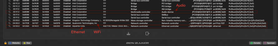

Attempts to Fix WiFi and Ethernet:
1. Applied Aquantia-macOS-Patches and set Kernel->Quirks->ForceAquantiaEthernet to TRUE.
2. Followed guidance from this MacRumors thread.
3. Added WiFi, Ethernet, and Audio device properties from Hackintool.
4. Mapped my USB ports.
The machine boots fine with the current setup. However, when I add AppleEthernetAquantiaAqtionFirmware.kext, it gets stuck at AAPL: #[EB|LOG:EXITBS:START]. I've tried troubleshooting this using Dortania's guide without success.

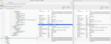

Hi Casey SJ can you please verify that these IORegistry files are ok, they seem to be but for some reason I cannot get internet using the ethernet. I know the cable is okay because it works fine with a dongle, furthermore when I go into system report on About this Mac it shows my ethernet info
Hi @tuort,
IOReg looks normal:

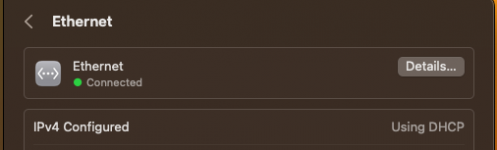

Can you confirm that Ethernet connection over your 10GbE port works — you can actually connect to the Internet after disabling all other network devices in the Network Settings panel?
Good morning, thanks for all your help. My motherboard is the Gigabyte Aorus z790 Master X. I have disabled my wifi, usb dongle and firewall but my Ethernet connection over the 10GbE port is a no go. As mentioned previously my system becomes unstable when trying to use just the ethernet, it randomly shuts down or the mouse will stop working.
@Danish297
@CaseySJ Sorry, I don't have cable right now to connect.:(
@Danish297 Hi nice to meet you. Our motherboards are exactly the same and our IORegistries show that both SSDT's are fine. I was hoping that you would have tested it with an ethernet cable but I see in your post that you don't have a cable at the moment. I have tested with a cable and as you see in my post to CaseySJ that I'm having a few issues. Hopefully these can be resolved.

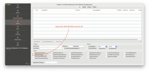

@CaseySJ
Hi CaseySJ, this seems to be a tough one. I tried what you suggested and still a no go. I disabled all other devices to no avail. I am including some screen shots. With this new SSDT do you have to do any patching?
Ethernet drivers in macOS require AppleVTD to be enabled. Looking at the IOReg files that you posted earlier, I can see that AppleVTD is not enabled. To enable it, please do the following:
  • In BIOS, confirm that Intel VT-D is enabled
  • In config.plist -> Kernel, confirm that DisableIOMapper is unchecked
  • Reboot and run IORegistryExplorer
If AppleVTD is enabled, you'll see it near the top of the device tree like this:
@CaseySJ
Bravo CaseySJ , you truly are a Guru. I can not thank you enough for the help and knowledge you have given me. My vt-d was already enabled in bios, I must have sent you a wrong IORegistry, however shame on me for not unchecking the DisableIOMapper especially knowing that it should have been. I must have overlooked it as a result of doing and trying out so many different config.plists. I am truly happy that I found this web site, do you think that the other ssdt's you suggested would also work.
Reactions: CaseySJ
@tuort
Awesome!!
Yes I think the other SSDTs may also work, but there could be subtle differences between different device IDs.
