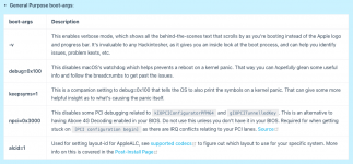

After quite some tests and changes, I managed to install 13.3 with OC 0.9.0.
Not sure however what did the trick, but I guess it was adding 'keepsyms=1' to my boot-args.
I did loose 'trim' on my ahci SSD drives. Again I'm not sure this is caused by 13.3. Can someone check?
2,392
Adding keepsyms=1 to your config boot args will not have been the reason for the OS updating/installing.
Have a read of fate information regarding the common boot args used in a Hack and you will hopefully understand why this is the case.
You must have changed something else, probably updating the AMD Kernel Patches to include the 4th CPU core setting, which is required to run Ventura 13.3.
