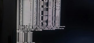

感谢您的回复,但根据您的方法,它仍然卡在这里。你能帮忙检查或修改它吗?

2,370
Try removing NvmeFixup.kext, see if that helps.

Thank you very much, but after deleting NvmeFixup.kext, it was still stuck there. The previous error was reported, and the problem with SSDT-RHUB.aml was still the same.

2,370
That screen image is showing a different error, one related to an incorrect ACPI address path in the SSDT-EC-USBX.aml table you are using.
You need to replace it with an SSDT-EC-USBX-AMD.aml table, as this table is defined to work with AMD systems. Your current one is set to work with an Intel system.
Replace your current SSDT with the one attached, see if that helps.
