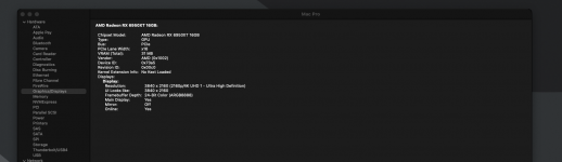

So far, results have been... mixed. My first attempt was done out of curiosity more than anything, but I popped that sucker staring into my mobo and tried to boot. Of course, that did not work. One can dream, right?
As folks had discussed across various forums, the 6950XT is in essence a souped up 6900XT so I still had hopes that this wouldn't be too hard a process. I went ahead with trying to spoof the device-id to just a vanilla 6900XT, as others have needed to do with the XTXH or whatever those were called. I'll admit, not totally sure if I did it right, but hey I booted into MacOS and I'm typing this into Safari now! I hope I won't have to flash the bios to 6900XT, but I do have experience doing that kind of thing and if worst comes to worst, I'll do it. But here's what I've observed so far:
  • In 'About This Mac' I guess I was able to get 'AMD Radeon RX 6950XT' to display properly! whoopee. it shows up.
  • ... but it also says I only have 31MB of VRAM
  • Continuing into 'System Report,' VRAM (Total): reads out to 31MB AND Device ID: 0x73a5, which if I'm not mistaken is for the 6950XT, not the 6900XT.
  • Although I'm using MacOS, it's buggy and laggy as all get out. Minimize too many things at once and the poor machine will lock up and lose its lunch. Moving objects/windows around the monitor results in tremendous amounts of stuttering.
  • Google Chrome is absolutely unusable. No images are produced at all.
  • Via HDMI, video output max was 1080p. No other resolutions available, even on my 4K panel. Switching from HDMI to Display Port on my LG 4K monitor unlocked the ability to display at 4K, but no scaling. Not sure why that made a difference.
  • Wifi cuts out sometimes? Using a replacement Broadcom card. This might be a separate issue though (ah the life of a hackintosher!)

Wow. This attempt was made solely by setting device-id to BF730000, and I did change the model to 6950XT, as you can see below. Popped the card into my brother-in-law's machine, booted from USB, and here I am. Appears to have full acceleration. Just as on my personal machine, this hackintosh has been updated to the latest opencore version. Such an interesting turn of events. I suspect I've got something in my own personal computer's config that is preventing proper spoofing for the card. I may attempt to rebuild that config from scratch. But for now- 6950XT DOES work in MacOS with spoofing to 6900XT device-id.
I will test things out to see if anything else about the system has been affected but things seem to be running pretty smoothly!
That's brilliant! Wow, you can also see the full VRAM amount it offers! That should be a very quick card. I'm very happy for you. 😊

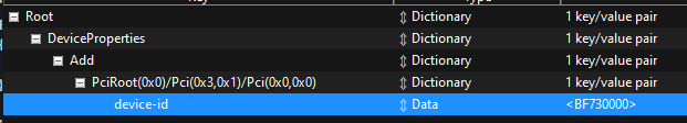

Use DeviceProperties property injection in your plist. Make sure you use your path. You can use Hackintool > PCIe > GPU > Right Click > Copy Device Path or use Device Manager in Windows
To convert Device Manager PCI Path to macOS PCI path:
PCIROOT(0)#PCI(0301)#PCI(0000)
PCIROOT(0) becomes PciRoot(0x0)
PCI(0301) becomes Pci(0x3,0x1)
PCI(0000) becomes Pci(0x0,0x0)
Then we replace # with /
PciRoot(0x0)/Pci(0x3,0x1)/Pci(0x0,0x0)
Image attached is an example of the DeviceProperties > Add entry. Make sure you have WhateverGreen added and agdpmod=pikera in your boot-args. Let me know if it works.
If it's not working, create an SSDT-Bridge using SSDTTime.
