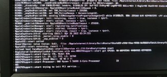

Stuck on AMDCPUSupport :: start trying to init PCI service...

I'm new to hackintosh, I tried to Install Monterey on my desktop, my hardware list as below:
CPU: AMD 5600X
MotherBoard: Sapphire Nitro+ B550i
GPU: Sapphire RX 6600XT
SSD: AData S11 Lite 512G
Memory: AData gammix d20 ddr4 3200mhz (8G *2)
I followed dortania's guide to gather files and patched CPU core according to AMD Vanilla OpenCore.

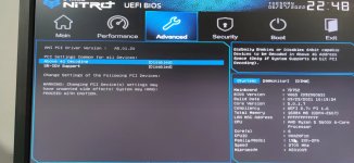

Either boot arg npci=0x2000 or enable Above 4G Decode in BIOS(resize disabled) cannot help... (boot-args : -v keepsyms=1 debug=0x100 alcid=1 agdpmod=pikera npci=0x2000)
Besides, I failed to execute ssdttime on the PC, don't know why...already put latest iasl the 'Script' folder..
Please give me a hand , thanks a lot.

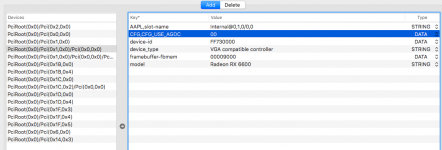

You will also need to change the Device Properties to this setting for your RX6600. Also need to have the agdpmod=pikera argument in the NVRAM boot-args section (replacing agdpmod=ignore) to activate the card:

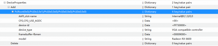

Hi @Middleman , thanks for your comment, I tried above setting but nothing changed. I also checked the display card's "location path" in windows , it should be 'PciRoot(0x0)/Pci(0x3,0x1)/Pci(0x0,0x0)/Pci(0x0,0x0)/Pci(0x0,0x0)', I used this value but still stuck on 'start trying to init PCI service...',
and 'agdpmod=pikera' already added
