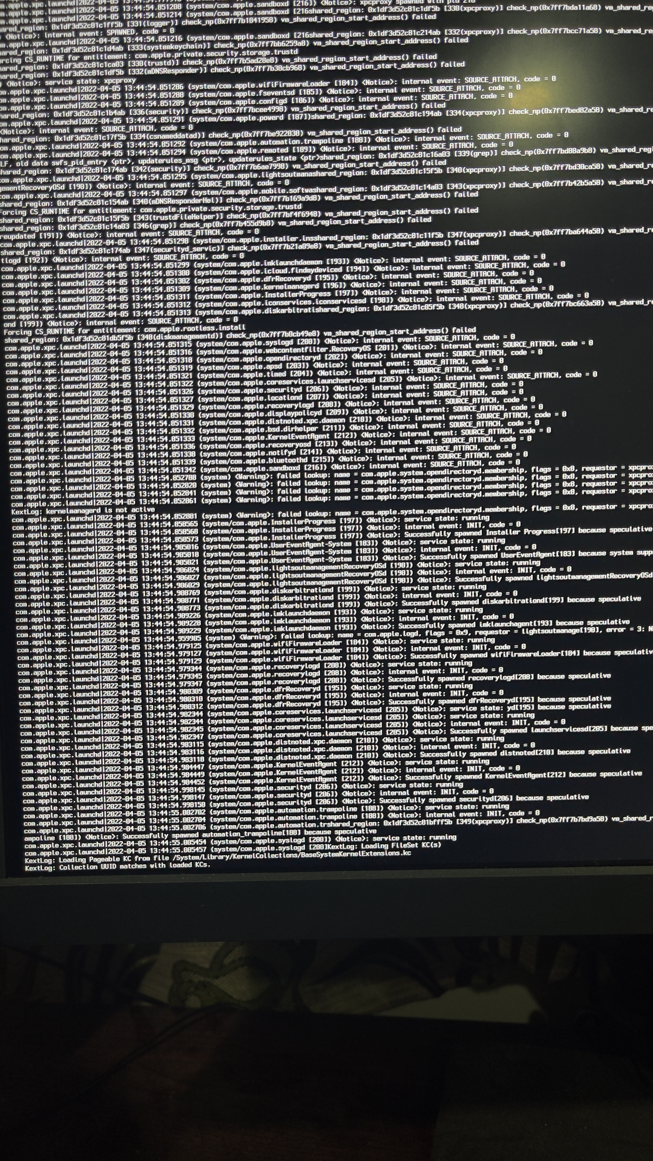

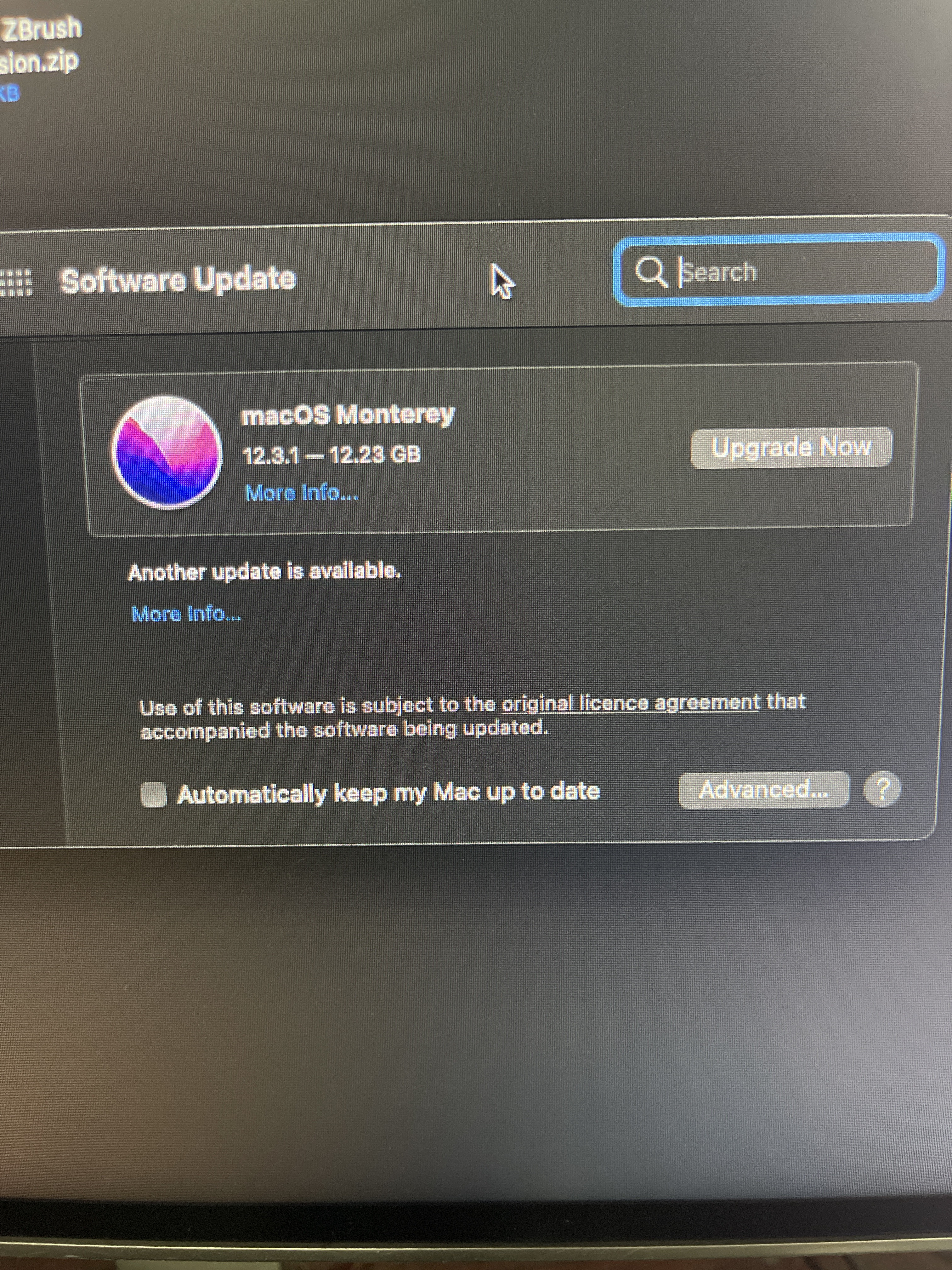

I tried to update it via store but it reboots again to bigsur please help with my problem,sorry for my english
when i try to update it stucks at apple logo

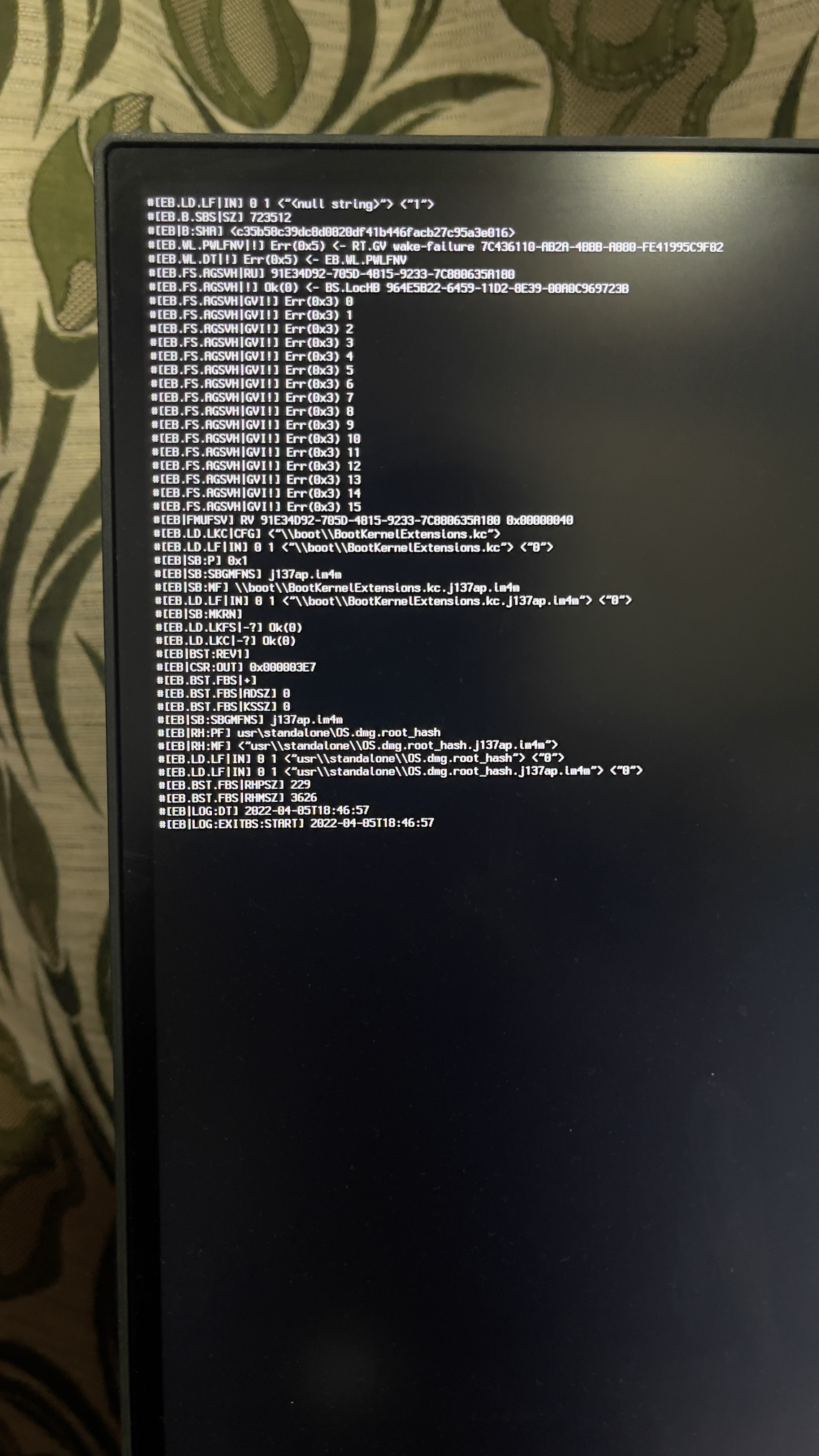

Without any problem am booting into big sur but when i tried to install monterey it stucks
When i tried this method to install monterey its booting back to bigsur

Screenshot 2022-04-06 at 11.13.29 AM.pngafter successfully installing 0.7.4 Opencore EFi Everything is working Fine
