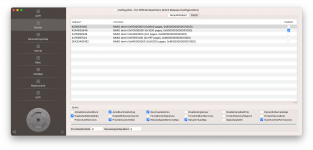

29:185 00:014 OCABC: MMIO devirt start
29:195 00:009 OCABC: MMIO devirt 0xF0000000 (0x8000 pages, 0x800000000000100D) skip 0
29:204 00:009 OCABC: MMIO devirt 0xFD000000 (0x1E00 pages, 0x800000000000100D) skip 1
29:213 00:009 OCABC: MMIO devirt 0xFEE00000 (0x1 pages, 0x8000000000000001) skip 0
29:223 00:009 OCABC: MMIO devirt 0xFEE01000 (0x11FF pages, 0x800000000000100D) skip 0
29:231 00:008 OCABC: MMIO devirt 0x880000000 (0x20200 pages, 0x800000000000100D) skip 0
29:239 00:008 OCABC: MMIO devirt end, saved 675840 KB
29:248 00:008 OCABC: Only 168/256 slide values are usable!
29:257 00:008 OCABC: Valid slides - 88-255

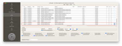

These are my current Booter settings:

If you enable first one your system should hang
I would try to add the third one
So convert tha hex to number and enabled it in config.plist
If it boots you can add the forth one
