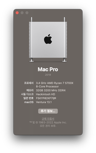

Not working
Not show Graphic on About this Mac
sleep

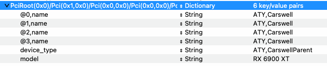

Try this revised and cleaned up config.plist.
  1. I have removed a number of unnecessary entries.
  2. I have added DeviceProperties for your RX 6900 XT GPU.
    1. Screenshot 2023-01-10 at 14.14.03.png DeviceProperties for RX 6900 XT
Try this config.plist and see if it helps detect and activate your RX 6900 XT.
Best to try it out on a spare USB drive.
So, don't replace your current config.plist until you know this config works.

My 6900xt device root is PciRoot(0x0)/Pci(0x3,0x1)/Pci(0x0,0x0)/Pci(0x0,0x0)/Pci(0x0,0x0)
Is it irrelevant?
2,379
Yes it is very relevant. If you don’t use the correct device path the patches won’t work.
So, you need to change the device path used in the config.plist, to match your graphics card path.
