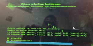

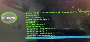

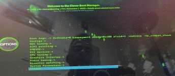

Hi @Middleman ,
I tried the EFI, but the result is same. Please see the EFI error screen shot file.
Also, I tried clover boot. Since working around clover is new to me, I don't know what to do next. I just took some pictures to let you know what I got on the screen. I hope you will guide me to provide you more information from Clover until you prepare a working EFI folder for Monterey.
Please have a look at these attached files. If you could manage EFI folder after checking these screenshots, it would be much appreciated.

Hi Arjun,
Okay that's good. What I need you to do is with Clover, grab a copy of your BIOS DSDT. To do that press F4 at the Clover boot menu. What it will do is dump a copy of your BIOS to the ACPI/origin folder. You'll need to compress it as zip file and send that to me.
With your OC error, it seems you may be missing a CpuTscSync or VoodooTsc.kext.kext.
Thanks for the device manager info. Could you please post what your hardware ids are for the display and for the sound?
