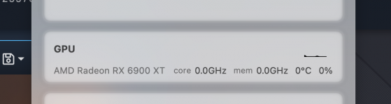

Can you check that the Kext has been loaded correctly?
kextstat | grep aluveitie
luchina
Jun 21, 2021
Can you download VirtualSMC from https://github.com/acidanthera/VirtualSMC/releases and then run the smcread from the Tools folder?
./smcread -s | grep -e "TG"
[email protected] Tools % ./smcread -s | grep -e "TG"
Unable to read smc value E00002C1
[TG0D] type [sp78] 73703738 len [ 2] attr [80] -> 3400
[TG0P] type [sp78] 73703738 len [ 2] attr [80] -> 3400
[TG0d] type [sp78] 73703738 len [ 2] attr [80] -> 3400
[TG0p] type [sp78] 73703738 len [ 2] attr [80] -> 3400
861
So everything looks fine, don't know then why iStats doesn't show anything...

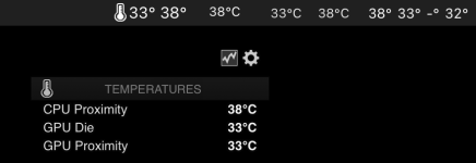

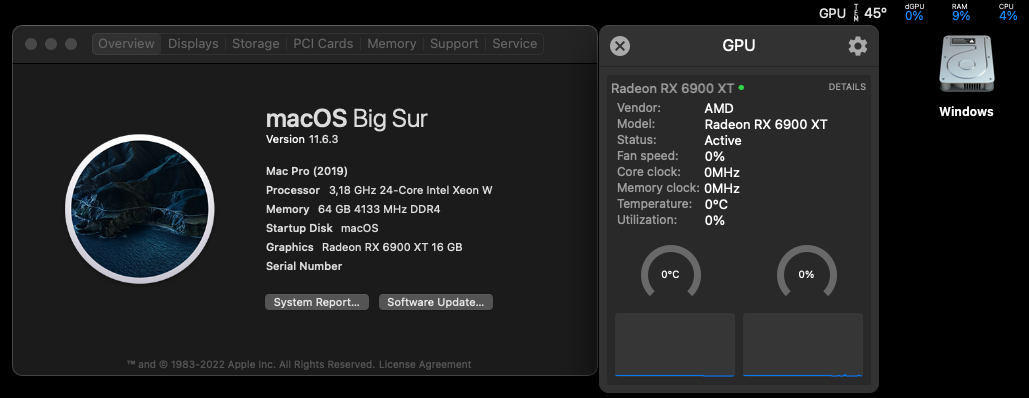

Hi~
Thank you very much for the tutorial, but I had the same problem with luchina.
My 6900xt temperature is only displayed in RadeonGadget, while in istat and Stats & eul it doesn't show.
I found in HWmonitor, the temperature is displayed independently of the 6900xt.
It seems to be displayed as the name of the CPU. But the temperature is the same as RadeonGadget
May I ask where am I doing wrong? Thanks a lot~

@zzhou What SMBIOS are you using?
The SMCRadeonGPU kext is publishing the values to 4 SMC keys that should cover most use cases.
But how tools like iStats read those and how they correlate it to a specific device is beyond my control. iStats is especially depending on the SMBIOS in how it reads out those keys.

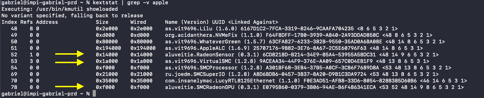

5t0l3n
Mar 22, 2022
Is working perfectly on monterey 12.3.1 thank you!
For the ppl that is having trouble with this... Check the order you loading the kext on the config.plist, it seems like there's some kind of incompatibility between AMDRyzenCPUPowerManagement.kext, SMCAMDProcessor.kext - RadeonSensor.kext, VirtualSMC.kext and SMCRadeonGPU.kext. After changing the kext loading order all began to work "correctly" (iStats not showing GPU2 - Die).
Kext order:
RadeonSensor.kext (latest)
VirtualSMC.kext (latest)
SMCRadeonGPU.kext (latest)
AMDRyzenCPUPowerManagement.kext (latest)
SMCAMDProcessor.kext (0.6.4)

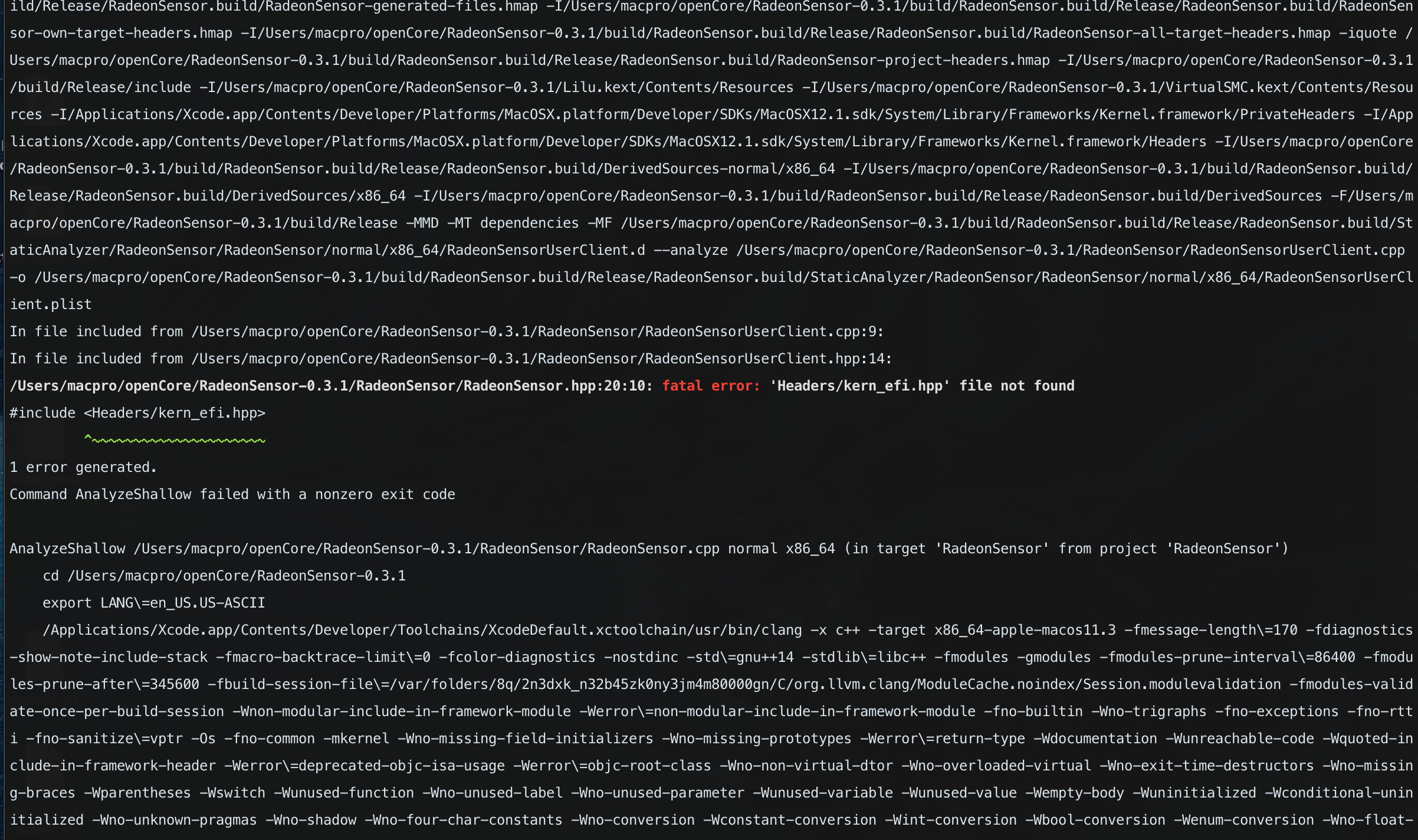

Hello everyone.
I'm having trouble to build the xcode project. Unfortuently I have no much experience with this.
I'm getting this error after I run xcodebuild
Any advice is much appreciated.
861
Place the Debug version of the Lilu.kext into the project directory. It contains all necessary headers.
