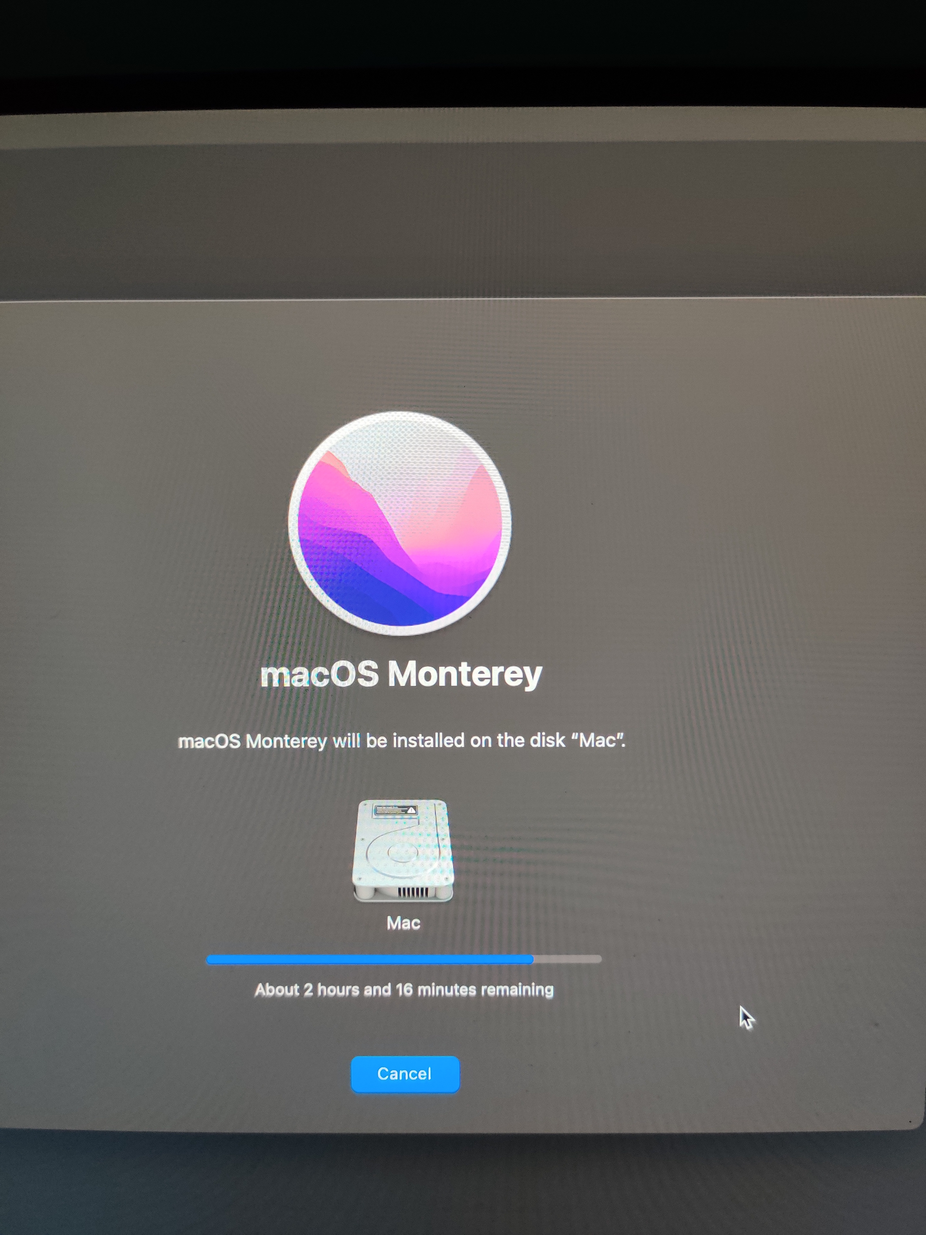

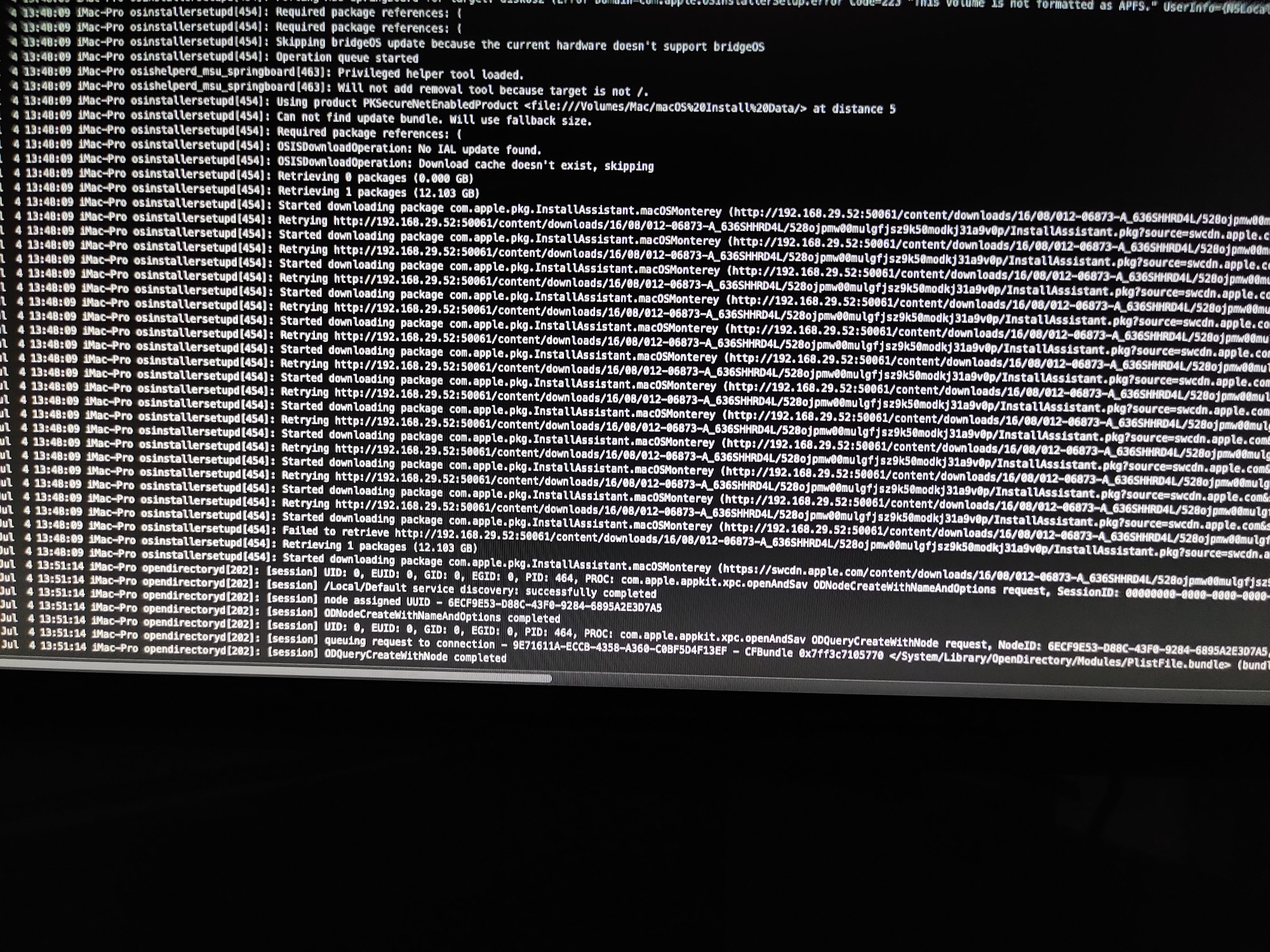

I am not able to proceed after it starts download changed ISP still no help please check If I am doing something wrong.
