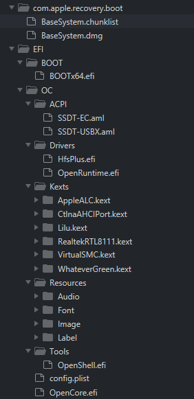

Hello,
2 years ago I successfully setup a High Sierra with Clover.
However when I changed my GPU from R9 280x to my current RX 5700XT, as expected I could not boot anymore.
So I gave up for half a year and now I am trying to install a ryzentosh with Big Sur. I followed the Dortania guide:
I made an installer on windows added the com.apple.recovery.boot, EFI, folder, kexts, etc etc. And when I double checked everything, I booted from the flash. However, it detected only the Windows and there was no other option. I thought I have skipped a step, so I went through them again, and I didn't change anything as everything seemed ok. Tried again, same thing.
So a couple checks again, and then I decided to try Catalina -> same story. As I saw that Big Sur and Catalina for me are with the same problem, I tried again with Big Sur, same checks added the kexts - no result, with the difference that I forgot to set the ScanPolicy to 0, sO i saw the openshell.efi as option.
I have been doing that for the last 5 days, researched other people's same problems but I just can't get it fixed. I modified the plist file with possible fixes but unfortunately nothing happened. Black screen with no logs or something like that - the only logs I have are from the opencore and each is 256KB but it is empty with : 0000 0000 0000 0000
What am I doing wrong?
My system is:
Ryzen 5 2600 4.0ghz oc
Asrock AB350M Pro4 - BIOS version P5.10
2x8gb 3200mhz corsair vengeance
and 3 ssds which imo is irrelevant to specify.
I am attaching the config.plist file and a picture of my usb structure.

Disable XhciPortLimit under Kernel -> Quirks. It can cause some issues.

Have you verified the BIOS settings you have with the guide?
Everything that is written there has been done, and for the stuff not mentioned is left in the .plist that I attached.

I see it now. HideAuxiliary is set to True. Press the spacebar when you get to the picker and it should show the USB ;)

Well finally it shows the correct options as listed here - https://dortania.github.io/OpenCore...llation-process.html#booting-the-opencore-usb
After some time spending with trying the prebuilt ACPI - SSDT-EC-USBX-DESKTOP.aml
and after that with the separated ones SSDT-EC.aml and SSDT-USBX.aml, somehow it started.
But it seems to be stucked on PCI Configuration begin.
